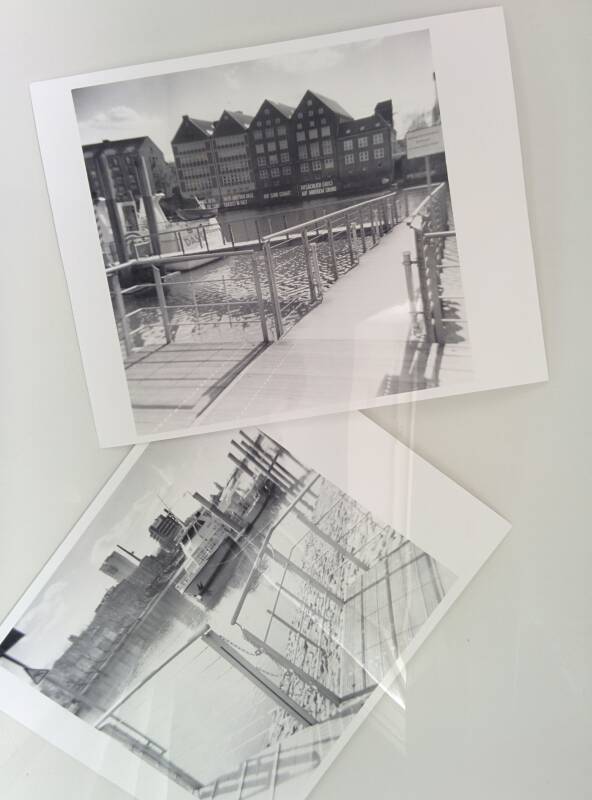

I have used Rodinal(1+100) stand for an hour at 17°C for Rollei RPX 400 negative exposed using Holga 120GFN on bright sunny day.
Results were pretty good and used Grade 3 for printing and required 1/4th of the stop to burn the sky.
On that day incident reading on open shade read EV 15 but camera was limited to 1/100th of a second either @f/8 or @f/11.
Stand development kept highlights very well, but I may not use it as a general purpose development scheme.
