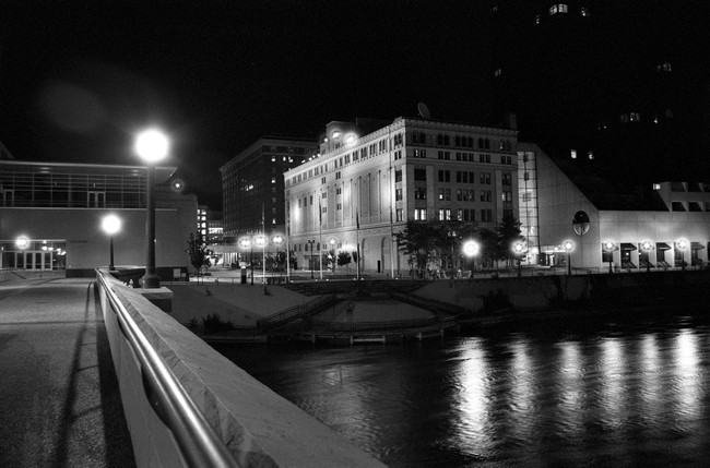

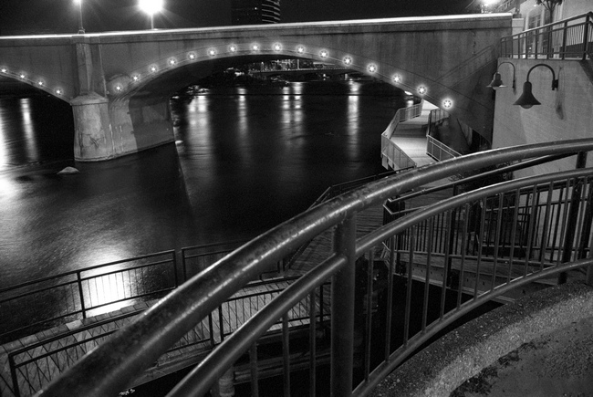

Here are the results.
jmailand said:
I just developed the roll using your suggestion for Rodianal 1:100 only thing I did different was develop at 67F and round the time up to 35 minutes to make it even for 5 minute intervals. The still wet results look promising. I will post a few scans when I get a chance, it may be a couple of months before I get around to print them properly. I'm now the proud owner of a Omega D2 I got off EBay for 25 bucks. My darkroom is going to have be rearranged to fit the thing in with my Super Croemga and my computer.
Thanks James.
These are some sample scans of the results I got using the above method. These are straight scans with no major manipulations. Just Resize and Autolevel in PShop. When I get some real prints I will stick a few in my gallery.
Thanks again for your help.
