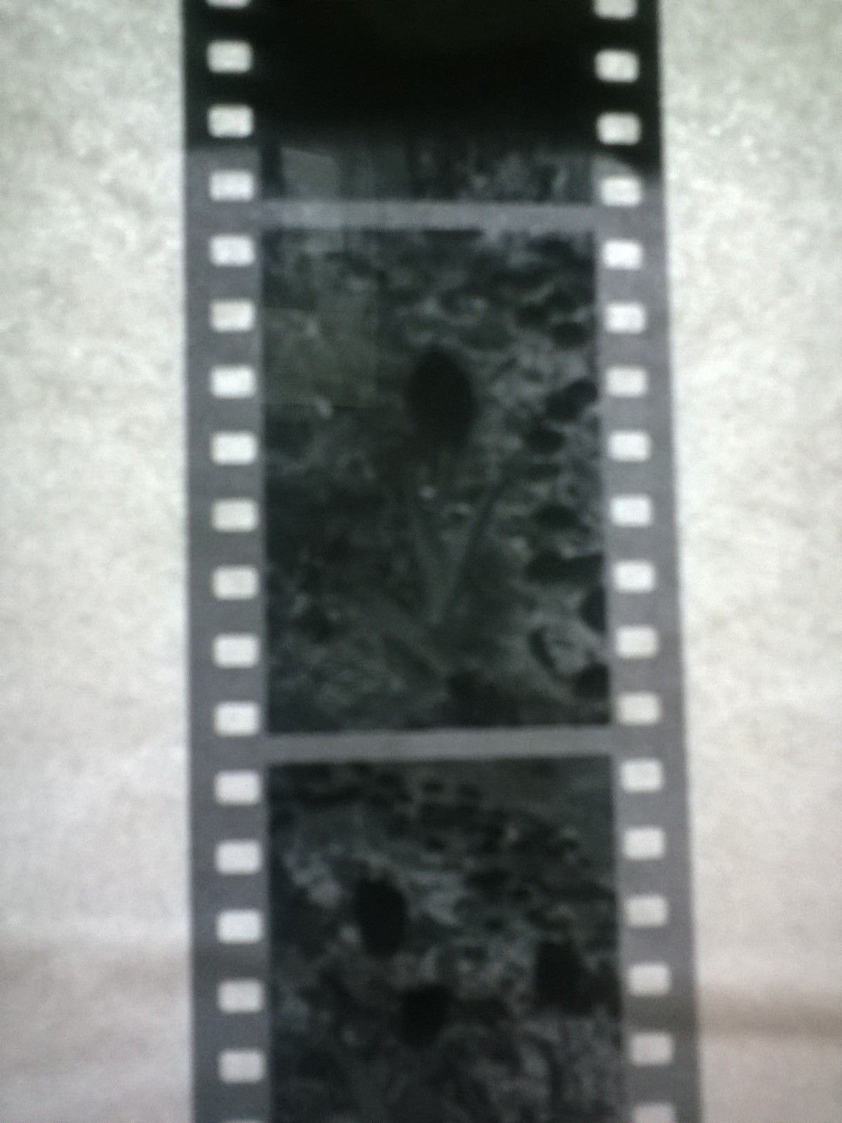

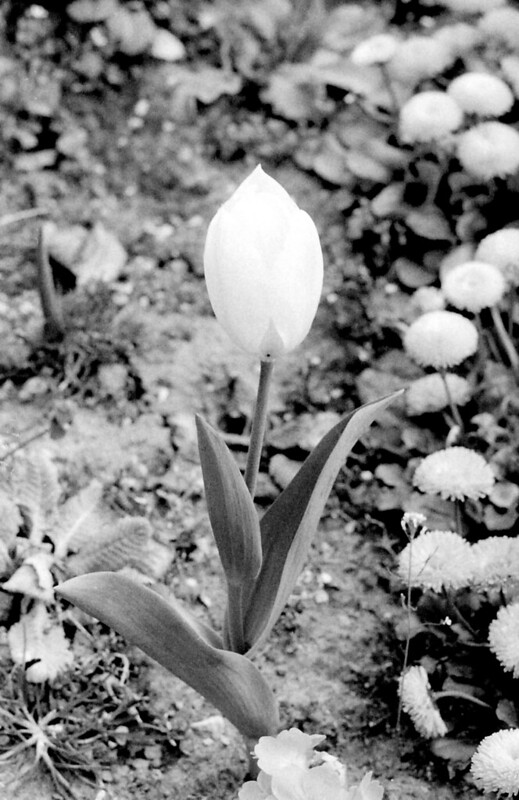

As it happens, while you were doing all that maths, I was developing some film using the usual 1:100, i.e. 3mml Rodinal for 300ml water per roll.
Here is one developed last night:
4-15-2016_041 by Ricardo Miranda, on Flickr
Yes, it is a low resolution scan and you can't truly judge by it.

There is a problem with scans which has been discussed before. Unless you turn of the autocorrect feature you really can't tell much. The scanner software will correct for such things as low contrast or density. You really need to make a wet print to accurately judge whether a negative is properly developed.
The cited article is very good and discusses such things as the minimum amont of Rodinal to use.
http://unblinkingeye.com/Articles/Rodinal/rodinal.html
That's true.
When I see folks talk about how "it will all work out" when talking about stand developing or really any type of developing, then seeing an image that was scanned from a negative has hardly any value at all.
The value would be a nice macro of the negative to see how it turned out.
I'm not criticizing, I'm just saying that I've done some stand development and I've done a lot of fudged up developing and the scans looked fine. It was only AFTER I went back to evaluate my crappy negs that I realized what was going on.

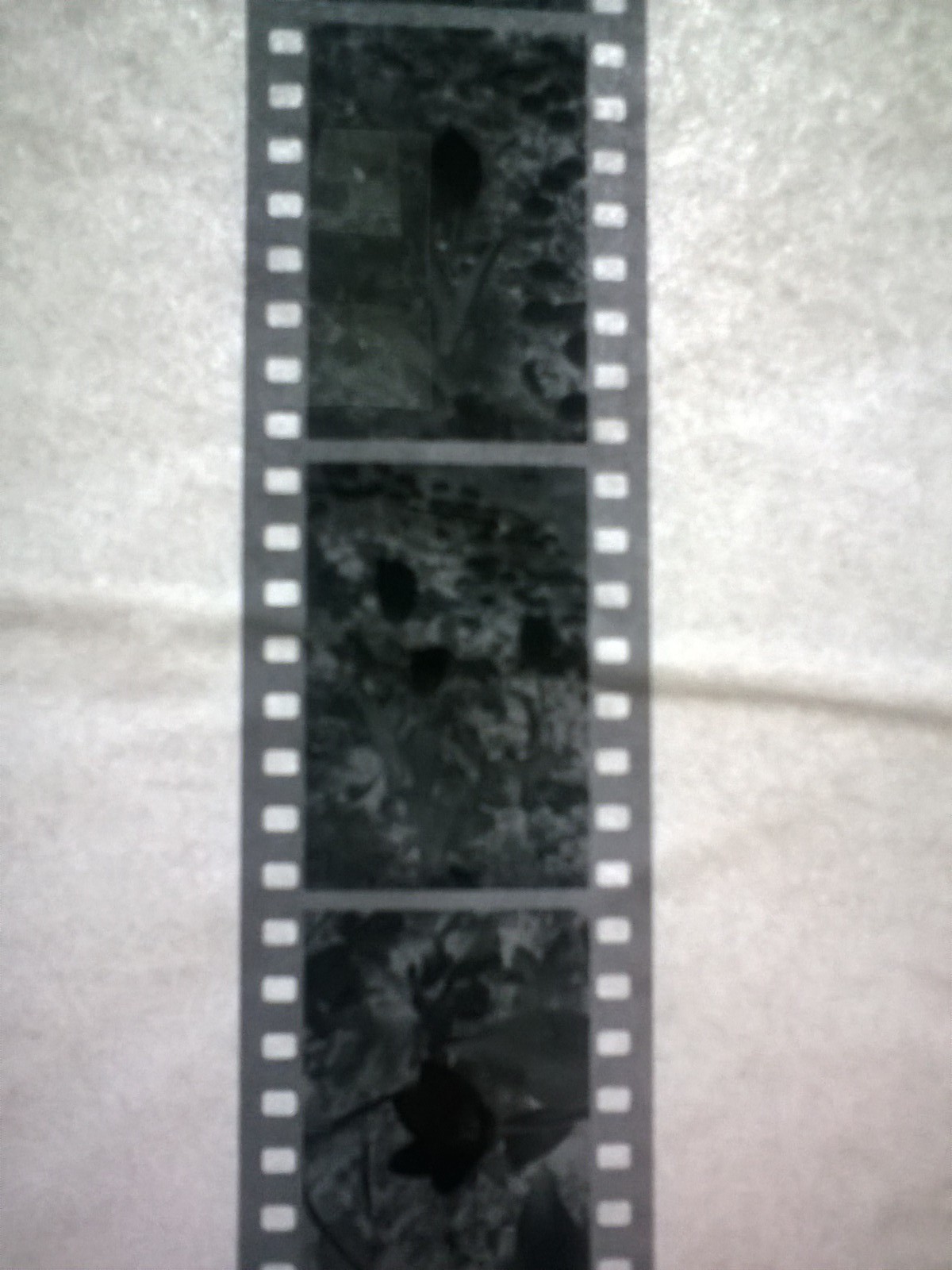

Sorry, I don't have a macro lens nor a light table. Too poor for that.
This is the best I could do with the crappy 2MP Stupid-o-phone:
Sorry for the quality.
Even at naked eye the negative looks properly exposed and developed to me.
It is no different than the 30+ years worth of lab developed negatives I used before.
