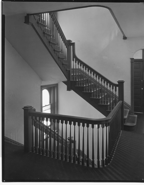

Hi Tim,
this is an AZO proof, I cannot scan negatives. the banister shadows (zone III) were EV2 and the lower window was 12 2/3 EV. 15 minutes stand, 5M each. I am going to try 12 min tomorrow. the lower window is a textured frosted glass. there is detail in the negative.

I suppose if it were mine, I would first see what can be done in the printing. I would probably print the brightest part of the wall as Zone 7 or 8, bringing the Zone 3 parts up to where they should be. Sometimes burning in is the best way to keep separate scenes separate while keeping the contrast in each scene visually interesting. I'm thinking of the window, of course. I'm a little dubious that the window is small enough to profit from the increased local contrast due to stand development. The detail in the frosted glass, yes. The average level of the glass, probably not.
I could be wrong. There's a first time for everything. (If you believe that last statement. you'll believe anything.)

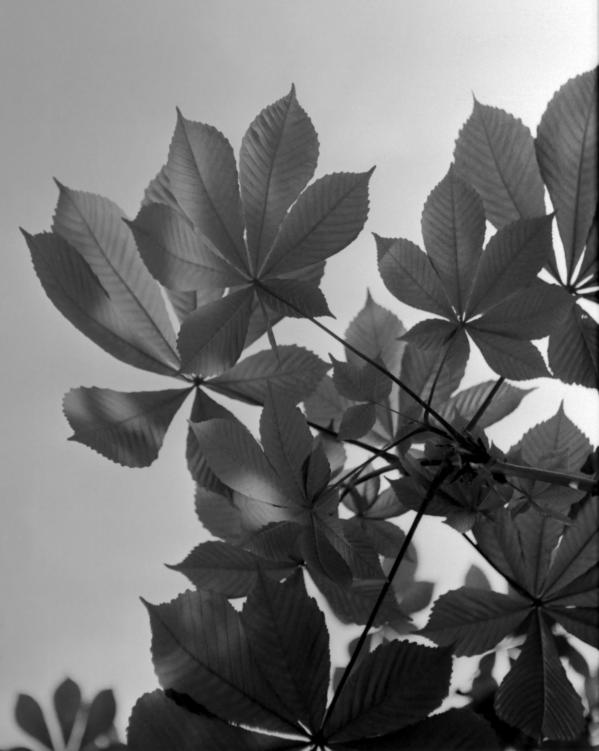

I've only recently tried semi-stand development with an Ilford Delta 100 135 format film in Bellini Hydrofen (equivalent of Studional or Rodinal Special) diluted 1:100. Initial agitation for 45s, than 25 minutes stand, 4 inversions, 20 minutes stand.
From my limited personal experience this technique gave me great separation among mid and dark tones and a very good acutance due to increased mycrocontrast. This is an example of what I mean.
