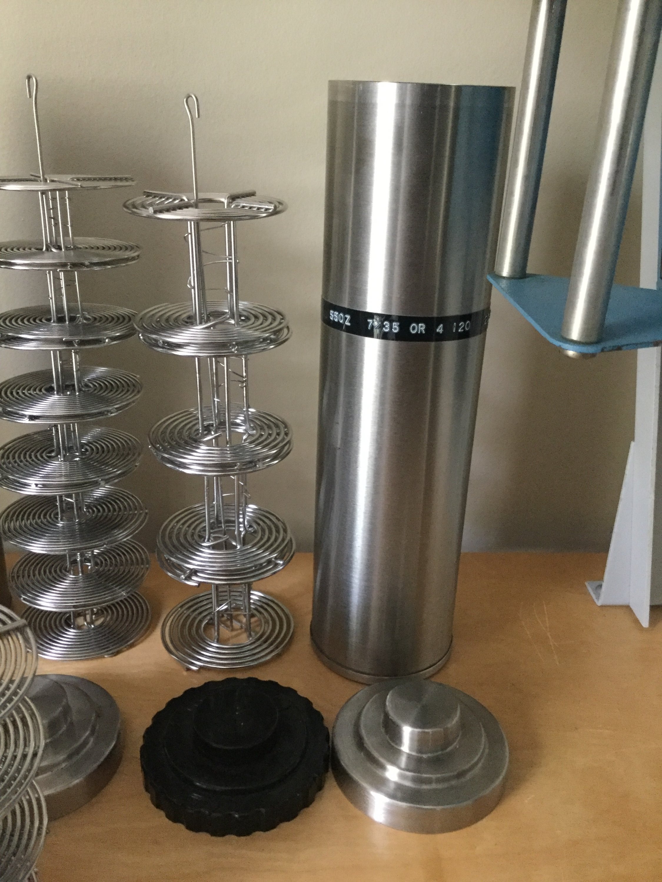

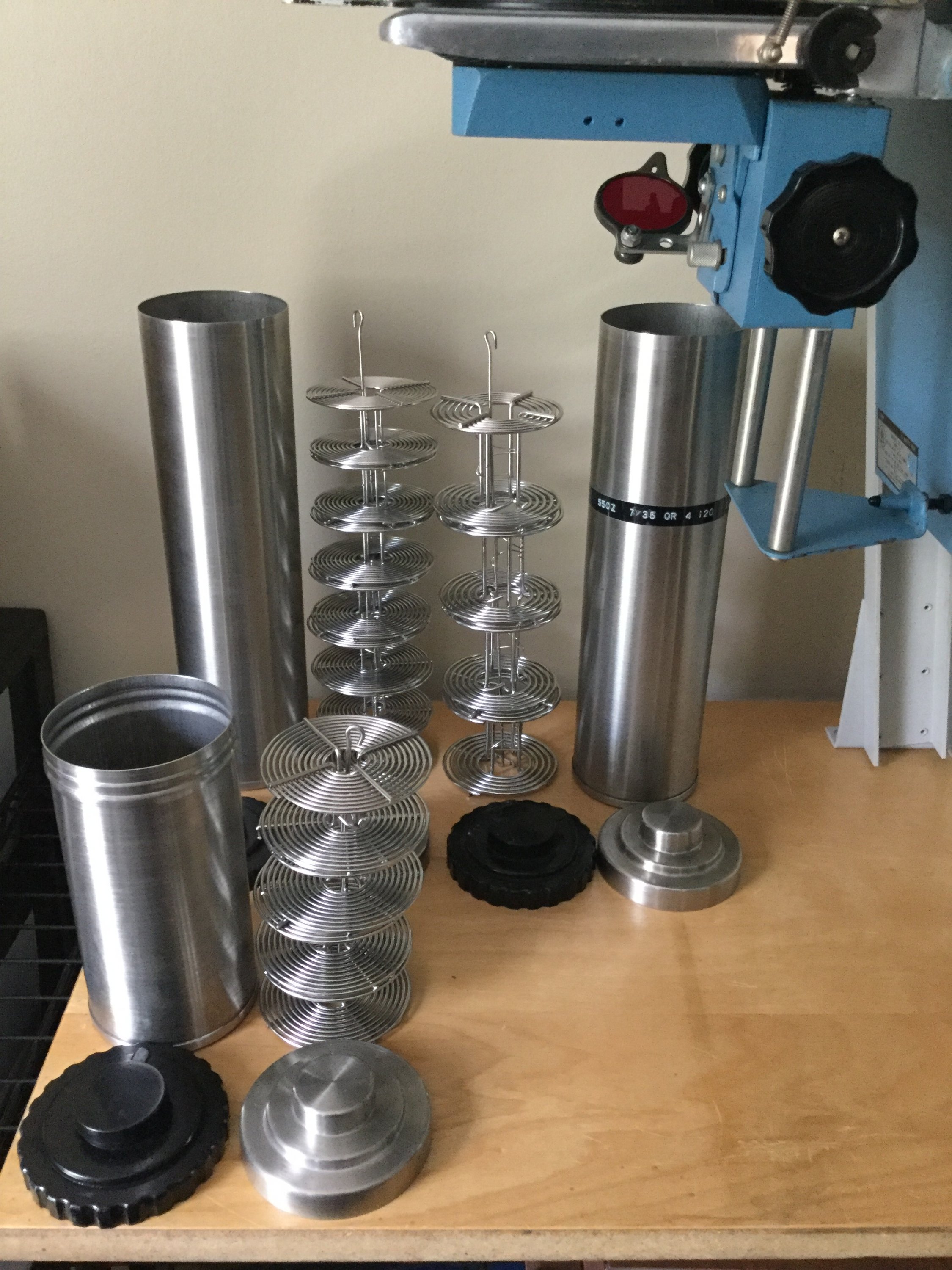

Hey Ted,
I have some tanks laying around. I’ll check them out tomorrow and send you a message of what they hold if you’d like.
I’m not sure what brand they are. The bottoms just say “made in Japan.
Thanks for taking those photos the bigger tanks are probably too big for HC-110 and daylight pouring.
