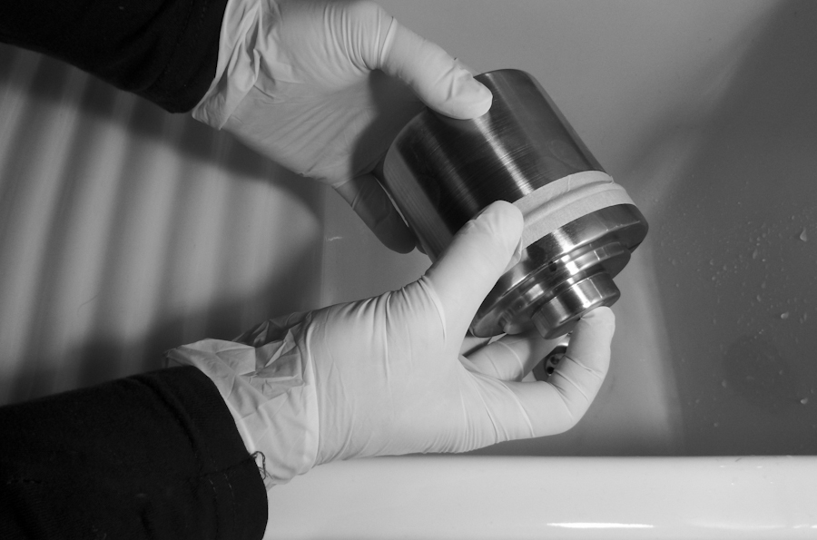

When I process C-41 film, which uses much higher temperatures, I use electric tape to fix the lid to the tank. If I don't, I have so much leakage that I lose too much of the chemistry (which I reuse).
I wouldn't expect that to work -- electrical tape in wet conditions. I might try it.
Jan 21, 2003
15,715
Switzerland
It works for me. There are a few little drops that leak out. It IS electric tape after all. But it prevents 99% of the leaking, which is good enough.

To keep them from leaking I would tape the lid on with Scotch super 33 electrical tape. Or you can get a late model Kindermann (Beseler professional ) with a leak proof lid..

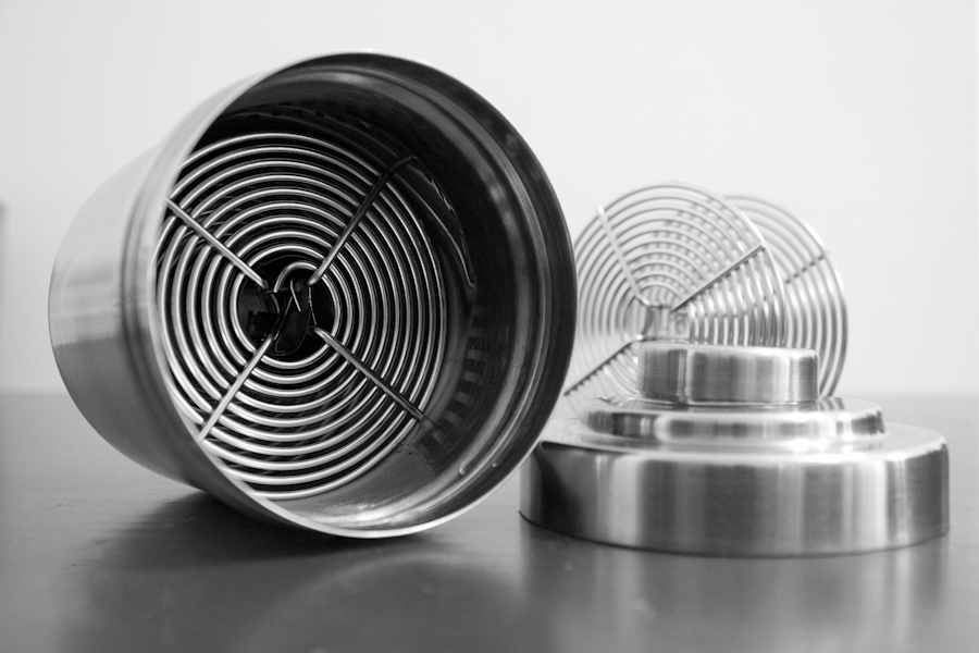

I have a tendency to hoard darkroom stuff. The Last and the best was the "Professional" I know they were all professional. I have seen some references that Honeywell had the lids and caps made in Japan, the tanks are the same. I bought one new in the mid 70's. They came in 2 35 mm or 4 35mm reel sizes.
These things fill like no other SS tank, and the flange on the cap makes it so you can actually remove when you are trying to get your developer out on time. These are both "Honeywell Vintage" products after Honeywell acquired Nikor. These are as much better than the ordinary as Hewes reels are better than Spiratone. You can fill these like the original system 4 Paterson tanks tilt the tank 45 degrees and pour out of a graduate into the tank in 5 or 6 seconds.

I started with brand new metal tanks from Freestyle and Hewes reels. The tanks all leaked to some extent. This one leaked badly because of the welder hitting the side as shown in the photo. Just poor quality control.
I switched to various plastic tanks (new Jobo, old Jobo, Paterson) and have been much happier.

All my tanks leak to some degree upon agitation. No worries - wear nitrile gloves and hold the tank over the sink while agitating.
Keep a finger on top of the metal lids just in case!
A little leaking from a top never hurts - just be sure your glass beakers don't get a hairline crack - and if they do, hope you are in your darkroom with the lights on when it happens!
