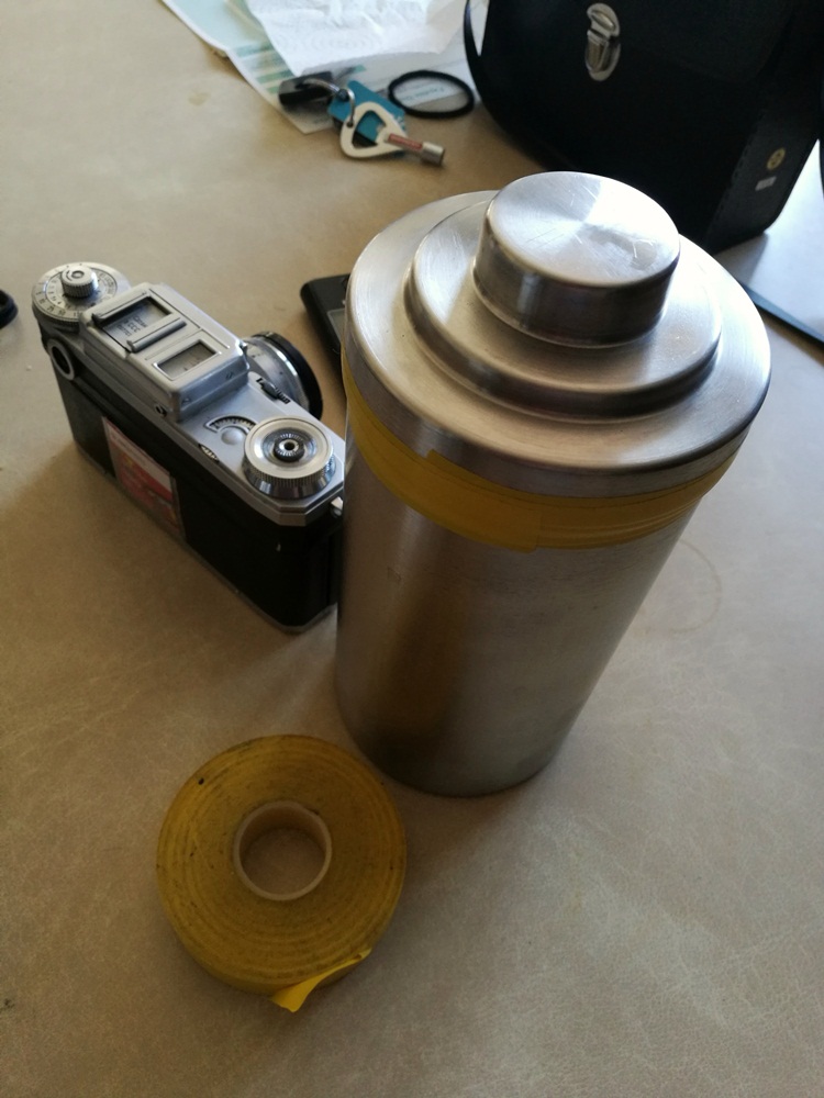

Or if you are the sort of person* who has countless rolls of insulation tape lying around:
* I use it for work!
^:laugh:
