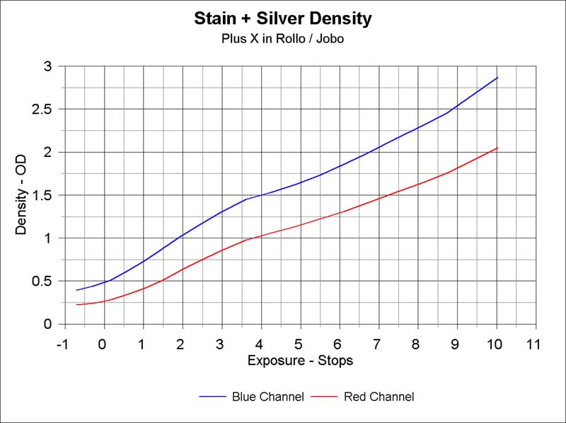

The ratio of stain to silver in pyro negatives may not be constant, contrary to assumption.
A typical density plot for a pyro negative is shown below:
Plus-X sheet film, projected 21 step tablet, Rollo Pyro 8 minutes, Jobo tank & spiral reel, Unicolor reversing motor base, Noritsu DM-201 densitometer.
The red channel sees little of the stain, the blue a lot. At first glance the stain density looks proportional to the silver non-stain density.
[The plot shows some interesting anomalies from being developed on the old Jobo 4x5 sheet film spiral reels. The curve shows a premature toe, an uplift where one would expect a shoulder and a large carbuncle in the middle. The increased density is due to increased development caused by greater agitation due to turbulence at the edges as they cut through the pool of developer in the tank. One edge of the film is at steps 1-3 (shoulder of the curve) and 19-21 (toe), the other edge at steps 9-11 & 11-13 (peak at 3.5 stops exposure). In spite of this the two curves run in tandem.]

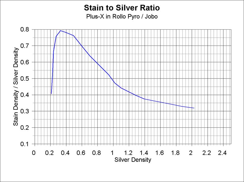

However, a closer reading of densities and calculation of the ratio of stain to silver, using the procedure detailed at the end of the post, reveals a different story.
A closer look at the first plot shows the same ratio variation - as a few minutes with a calculator will show.
I don't know the reason for the variation.
The Experimental Procedure
  1. Plus-X sheet film was exposed to a projected step tablet
  2. The film was developed in Rollo Pyro in a Jobo tank / spiral reel on a reversing Unicolor motor base
  3. Densities were measured with a Noritsu DM-201 color densitometer
  4. Silver was bleached away with ferricyanide
  5. Densities of the resulting stain-only negative were again measured
  6. Silver density was calculated by subtracting the stain densities measured in step 5 from the stain plus silver densities of step 3
  7. Stain to silver ratio was determined by dividing the blue channel stain measurements from step 5 by the visual channel silver densities calculated in step 6 - these are the values plotted as a function of the silver density from step 6. The same shape of curve arises if one has exposure as the horizontal axis.
Jim Noel
Mar 6, 2005
2,261
What you have done is likely correct for the developer you used.
However, it is inappropriate to group all pyro based developers. The two primary pyro developers, Pyrocatechol and pyrogallol, stain differently and each different formula for these has a variance in response.

It seems the total of silver grain and pyro stain may be different than the sum of its parts. Could it be that what some think is a filtering effect from the stain is actually the result of a nonlinear combination of silver to stain creating a different characteristic curve than if the two combined in a more linear way?
The optical densities of two compounds add in a linear fashion. This is a very, very, very fundamental property. One would have as much luck arguing that Force does not equal mass times acceleration for some magic compound. Oh, hell, I have a good friend who believes in anti-gravity, space aliens and regularly talks to ghosts. Belay that last point.
Anyway...
The stain is stuck to the gelatin and not to the silver. It isn't properly referred to as stain but as tanning - as in leather.
It is reasonable to assume that under the alkaline conditions of tanning development, the quinoid oxygen atoms of the oxidized developer become strong proton acceptors from amino groups of the protein, and the polymerization in situ of the primary oxidation products to polyfunctional substances of higher molecular weight serves to crosslink the polypeptide chains. (*)
C. E. Kenneth Mees, The Theory of the Photographic Process, Revised ed. (New York: Macmillan, 1962) 584​
Well, that about obfuscates that point to death.
(*) In English this time:
Under alkaline conditions pyrogallol molecules, after they have been oxidized by the act of developing silver, stick to the protein in gelatine. They also stick to each other forming long chains that join protein molecules together.​
Hence the relief patterns you sometimes see on pyro negatives where the emulsion shrinks in areas of high optical density.
More gelatin relief is one reason old-style films with unhardened thick emulsions are preferred for pyro. The thin well-hardened emulsions of modern films show little to no relief.
My understanding was that the oxidized pyro-molecule (whether it is pyrogallol or pyrocatechol) cross-links adjacent parts of the gelatin molecule. This cross-linking can occur between two molecules of gelatin, or parts within the same gelatin molecule.
Kirk Keyes
Jun 17, 2004
3,234
Portland, OR
Perhaps it shows that the tanning requires a little bit of development to get the stain formation going, then as the amount of development increases the oxidized pyro is able to take advantage of the large excess of nearby gelatin to more efficiently from stain. As more development continues, the large excess of available gelatin for stain formation decreases as it is crosslinked during the formation of the stain. And when there is a large amount of development, the stain continues to consume available crosslinking positions and the formation of stain decreases.
There is probably some steric hindering occuring as the gelatin becomes increasingly crosslinked.

Kirk and Nicholas, you are both right but are using different words.
The important thing here is that the quinone form of the oxidized developer crosslinks gelatin and becomes colorless! It loses the double bonds that create color. The excess quinone and the hydroquinone form usually form a quinhydrone which is highly colored. In fact, the parent compound, quinhydrone itself, was used to make green ink! So the excess oxidized developer that does not form crosslinks with gelatin is what is the color former in this case. The color itself is a function of the ratio of quinone to quinhydrone that is left in the coating and if it varies, then the color varies with this ratio. I see no evidence of variation in the samples posted so far, therefore it must be constant throughout the coating.
