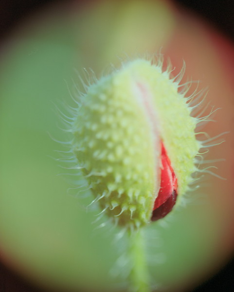

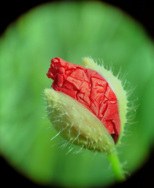

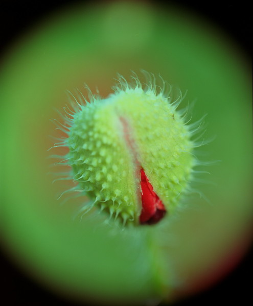

Here are the results from my lens stacking experiments. As mentioned before, the windy weather and the flimsy setup did not exactly help with sharpness, at full resolution motion blur is quite visible. I had to grab the 110 during the shot in order to provide support to the setup and in order to stop down the lens, which also caused motion blur, especially if one does 1/4 to 1/2 second exposures. If the 110 is stopped down, a certain amount of vignetting also occurs as shown by the images.
My conclusions are: since the inversion ring was really cheap and since I had the 250 and the 110 anyway, this setup was an interesting learning experience for stepping into the macro world.
PS: I love the new Portra 400 for its color rendering and latitude!

Nice! thanks for sharing. I will try some experiments like that soon too probably. Agreed, stabilizing the rig is the hard part, probably. Some sort of custom bracket would probably be the ideal solution, or maybe 2 tripods or something.

If you want to proceed with a setup like this, here is my advice:
  • Supporting the lens is one thing, but you also need to take care of closing the aperture on the stacked lens. This is what probably caused the most shake in my setup.
  • Think about using a flash for lighting as this macro setup needs a lot of light.
  • As with all macro setups alike, DOF will be razor thin. I used F/22 on my 110 lens and still got too little DOF as the example pics show
Before I took my shots I used a fake TTL technique to guestimate the required exposure compensation. For this I placed the camera opposite to a wall and compared the meter readings with reflected light meter readings through the view finder (protected against stray light with a dark cloth). Here are my rough compensation values (250mm wide open, 110mm stacked against it and progressively stopped down):
F/2.8 -> 4 EV
F/5.6 -> 5 EV
F/11 -> 8 EV
F/22 -> 10 EV
F/32 -> 11 EV
Due to the high inaccuracy of my setup I would take these values +/- 1EV, but that's still plenty accurate for negative film. The EV compensation values are the difference between direct meter reading of the subject and what you should set your camera to to get a proper exposure.
