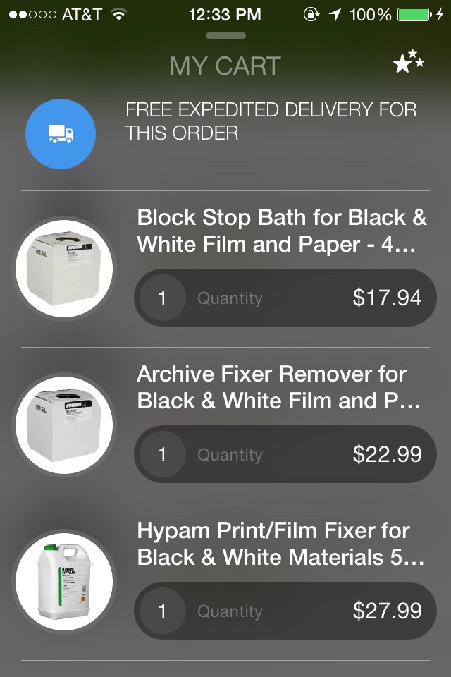

OK, so my cart looks like this... (There are more things).

My immediate hesitation was that I'd rather focus on using a system that works well for both film and paper, I obviously have a system that works well and I don't have any kind of issue with whatsoever and that is with using all Ilford products.
But because I'm starting to do printing at home, the cost increases tremendously if I continue using all Ilford products.
So let's hope this system works :smile:

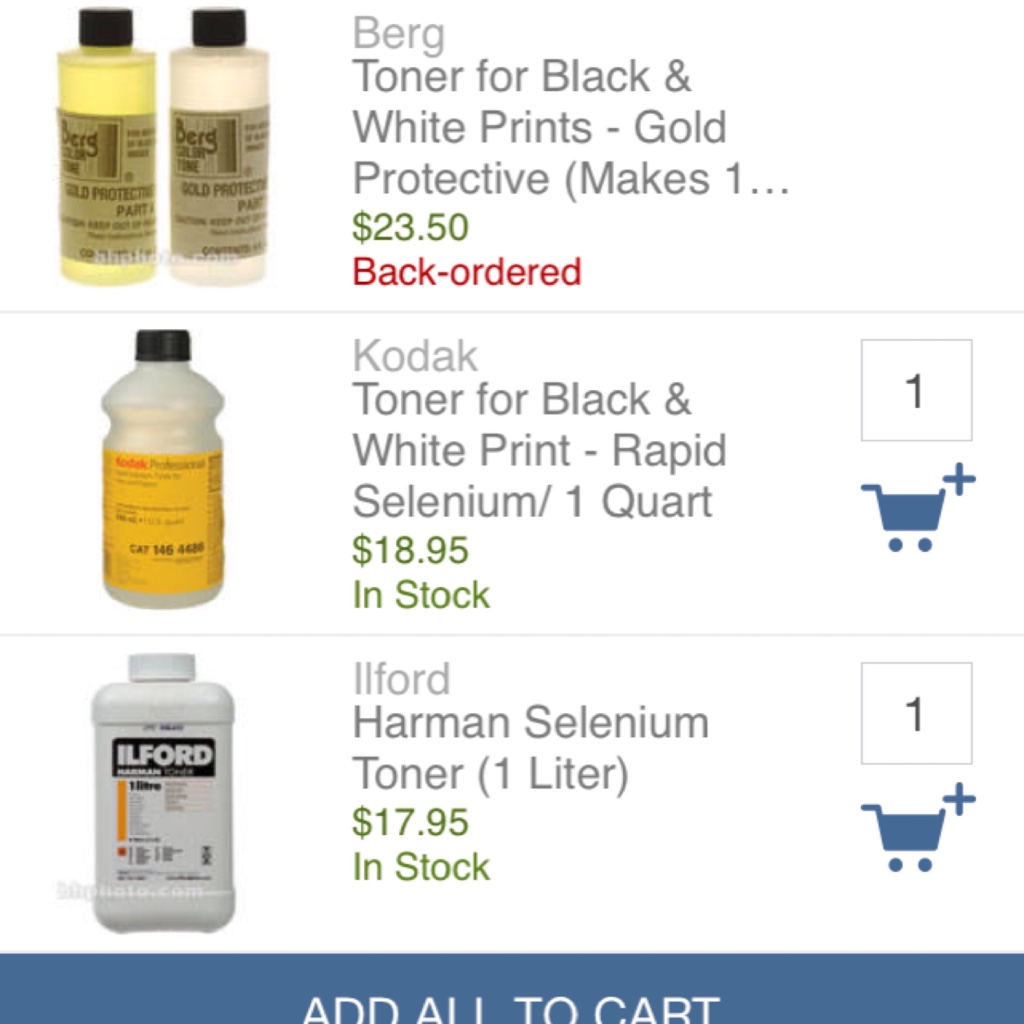

Since I have you all here, does selenium toner matter which brand?
And what's with this gold stuff? It says if you use it you will NEVER have faded prints, it doesn't just say "archival" but literally says it will never fade, that's a pretty bold claim, or GOLD claim :whistling:
What do you think?

I don't think there is a functional difference between Kodak and Ilford Selenium toner. There is a very good chance that it is made in the same factory (Tetenal in Germany) and may actually be identical.
The square Ilford bottles are nicer, but it is easier to pull off the Kodak sealing tab when you first open it :smile:.
And as for the spigots: Dead Link Removed
The Sprint products I am familiar with that are packed in cubes do come use spigots, FWIW, though I don't know if they need to be ordered separately.
I use Ilford selenium, as it was easy to order from wherever I ordered it. Presumably it has tested compatibility with Ilford papers, where Kodak's may not, but I don't think it makes a big difference.

In my experience, the Kodak and Ilford selenium toners do not produce identical results when diluted the same. I found the Ilford to be more active and needed additional dilution to make prints look like those toned with Kodak.
I'd go with Greg's advice on this. I expect he does a lot more toning than I do, and any time I've switched back and forth (due to local availability) I've usually had a time delay between finishing off with one old batch of one brand's toner, and starting with a new batch of the other brand of toner.
