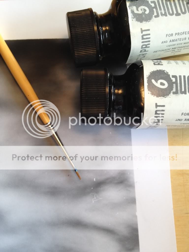

I have an unopened Spotone 5 and 6, a nice brush, print below needing spotting is toned in gold (has a hint of blue-black), MGIV matte, is this the wrong Spotone (5 and 6)?
I think I need Spotone 1 for cold bluish prints, that correct? My Phil Davis book seems to indicate Spotone #1 is for cold-bluish, #2 is for warm-brownish and #3 is for neutral black. Then what are 0, 4, 5 and 6?
Now the problem, Spotone seems no more. I don't see anything for blue-black prints as a leaf through my Freestyle catalog, any advice?
Thanks!

Never heard of #4, #5, #6. Look at their description and color coding on the label. Oddly the scan of your 5 & 6 seem to carry the same visual as the neutral #3.

I think the #5 and #6 may be recent formulations for Multigrade papers. Maybe you already have what you need.

Thanks all! That 5 and 6 I have maybe they came from a parallel universe, the only mention to 4,5,6 was in some other forum where someone said the 5 was neutral (I had a #4 that was broken and thee that bottle out). None of the bottles say anything either, I was given these so that explains my ignorance of what I have if you wonder.
I just brushed some 5 and 6 undiluted onto some scrap FB paper and it looks "black". I am going to get my #1 later this week so should be good, will cut it with my 5/6 if it is too blue. We shall see, my wife paints with the kids every weekend, I am glad I can join them now with my own "painting", I guess I am more of a Seurat kind of painter:smile:
ROL ha! Yes I prob should have not put my inks/brush on the print like above, I crammed in one frame so I photograph the illusive 5 and 6's.
I did find a picture of the set you describe above, not like what I seem to have been given:
