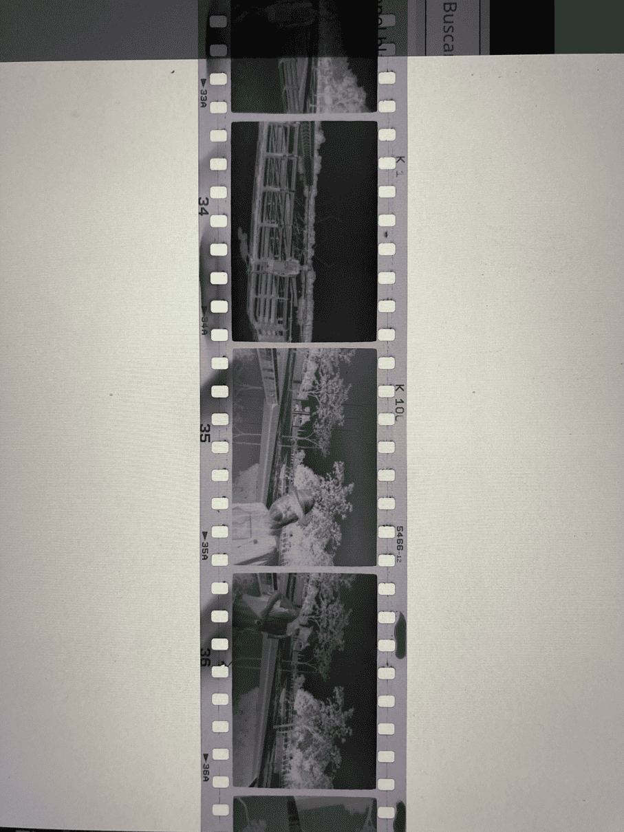

Anybody knows what is the likely causo of this spots in the negative?.
What I've learned so far:
It doesn't happen always. Most of my negatives are ok. but sometimes this problem come up.
Is not light leakage, because pattern is inconsistent and happens with negatives exposed with different cameras without light leakage - I've developed film for all of them and no problem.
Always located in the same side of the negative, but in different shape.
Sometimes they have the shape of a sprocket hole.
I only use Kentmere 100 and 400. Spots happen with both of them.
I use two kind of tanks: lab-box with continuous agitating -hence reel axe is horizontal- and an old tank Patterson style -reel axe is vertical.
Developer is Infosol 3, Ilford recommended times, 1+9 dilution.
Questions:
What do you think could be the cause?
Could it be something related with bromide drag?
Something related with temperature? I develop at 20C, but maybe the temp of the tank itself alter the temperature.
Many thanks in advance.
Best.

That looks very much like a light leak, I can't imagine anything else causing this. Bromide drag or temperature issues won't cause so much density in limited areas. Inconsistent patterns are fairly normal for light leaks. Maybe your cameras used to be ok but aren't anymore? Or you've usually used them in less direct sun or with a half case? Or you've mixed the films up and they actually are from one camera? I'f just re-seal all suspicious cameras, it's usually not a lot of work.

However, it is very similar to backlighting. What cameras do you shoot with? What is their age? Do they have a self-timer lever?

Light leaks, yes. Are your cassettes factory loaded or do you bulk load? There is a leak somewhere in your regimen.

That's likely a light leak from the top of the door near the take-up spool. Sprocket hole imprint would be a giveaway. Is the locking side of the door near the take-up spool? Leaks can happen there.
But if it happens with different cameras I'm not sure.

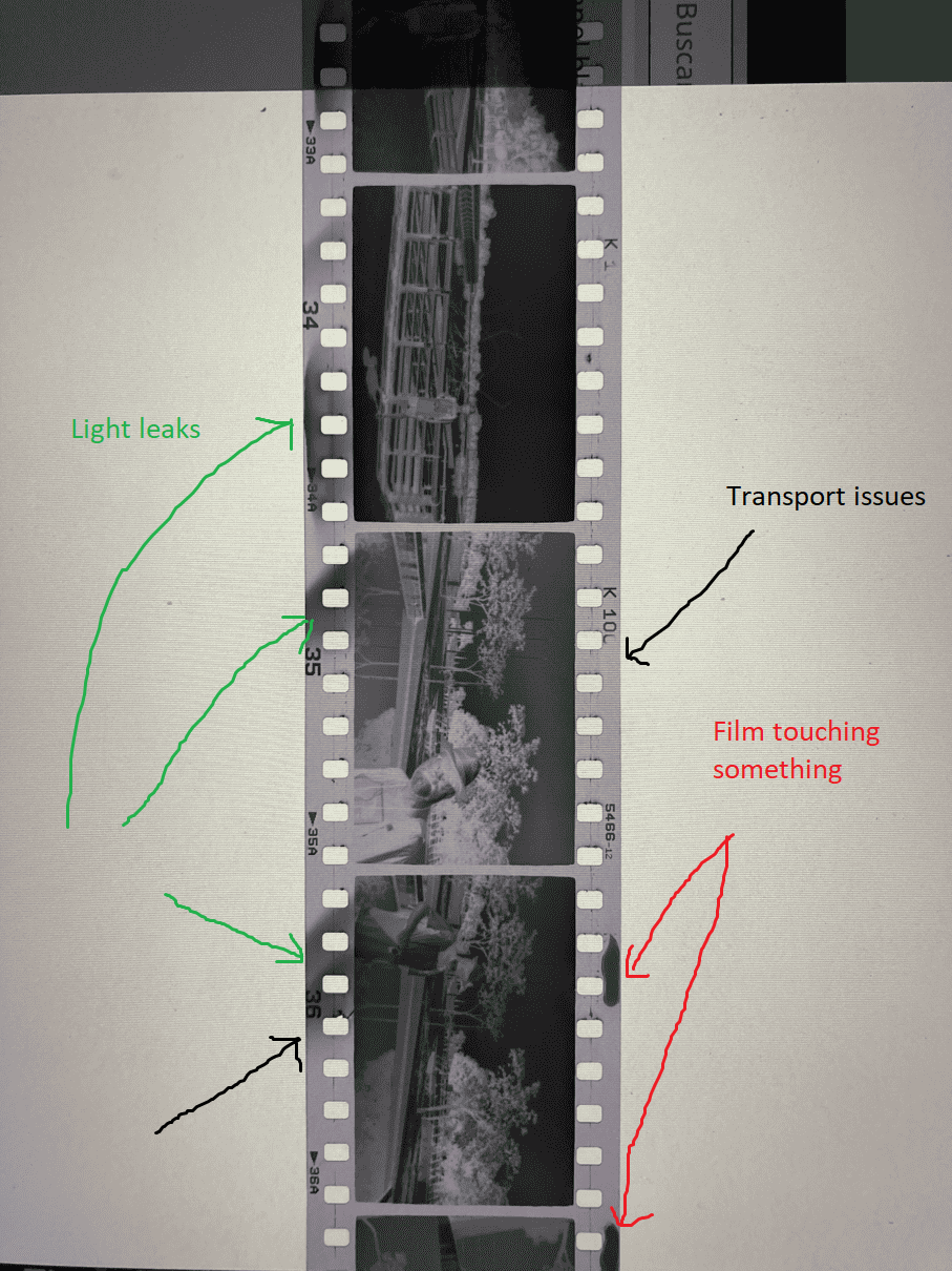

Looks like three problems:
1. Light leaks
2. Film touching itself
3. Perforation areas are roughed-up with scratches and even a chip in one perforation.
I would certainly check your camera back light seal for this roll.
Looks like something in your routine is very rough on the transport of the film.

Dear all,

I know that they seems to be the main suspect, but I'm reluctant to think they are. Spots have happened with an Olympus OM10, a Yeshica Electro 35, -both with new seals-, and with a Fed-3. There are negatives developed with Olympus and Yashica spotless.
In addition, spots are always in the same place, where the pre-printed numbers of negative are. That correspond to the bottom of the tank - but for Lab Box, that could be the bottom as well in the part more distant to the crank link.
@Kino
Thanks for your image, it's very clear. 1. Light leaks could be, but I'm more in something like bromide drag and agitation problem. 2. Fully agree: camera is a FED 3 that I'm using as a pin hole. The less to say is that this camera doesn't treat negatives softly. 3. Agree again, most likely the border of the slot in the plastic reels.
So, for me, 2 and 3 are trivial, the real problem is 1.
1. Light leaks
I agree with all these remarks.

I'll jump on the bandwagon: Kino seems to have nailed it.
You mention using a Lab-Box to develop at least some of your rolls. I've never used a Lab-Box, but I'm suspicious that their fairly clever method of daylight loading, where the film is un-spooled from the canister in one (ostensibly) light-tight box and transported onto a reel in another light-tight box via a crank, seems like it could go wrong a few different ways if something wasn't lined up just right. I'm even wondering if all three issues Kino observed (light leaks, spots from film contact, and longitudinal scratching) might not be the result of the same problem. Perhaps something in the film transport mechanism of the Lab-Box is misaligned?
Thank you for your help gentlemen, I really appreciate the time you have devoted to it.
Problems 2 and 3 in Kino list are no worries. I knew that this camera treats badly negatives -FED 3 has a reputation of damaging sprockets holes in negative- and that when the negative touches the lips of the reel slots is normal find this kind of spots.
Real issue is problem 1, light leakage or not?. Is no wonder that everybody thinks that there is light leakage. Myself, at the beginning I was thinking exactly the same.
Then I looked through my negatives, and found spots from three different cameras. Two of them had their light seals changed, and the location of the spot in the negative was always the same, regardless the camera, so I found this not really consistent with light leakages and started to doubt about it. As the shapes of the spots itself match much more to a sort of chemical dragging I thought this was a good line of investigation. Actually, the agitation has been always done rotating the reel with a crank, never inverting the tank, hence I think that there could be different layers of bath with different development by-products concentration. In addition, to agitation style, difference of temperature between presoaking and development could have its influence as well.
So, I'm not completely persuaded that there is any light leakage, of course could it be, but could it be not.
But enough of beating the bush. Next simple step is develop some rolls from this camera in a Paterson tank, with proper inversion, ensuring that presoaking and developing temperature are the same at 20ªC and watch the result. And of course, recheck the cameras looking for a source of spurious light.
