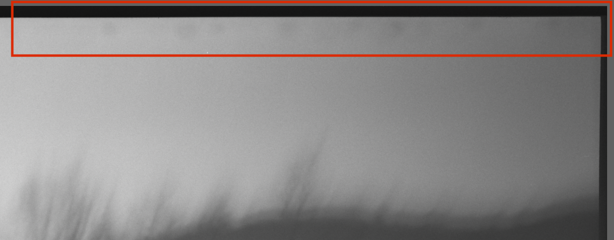

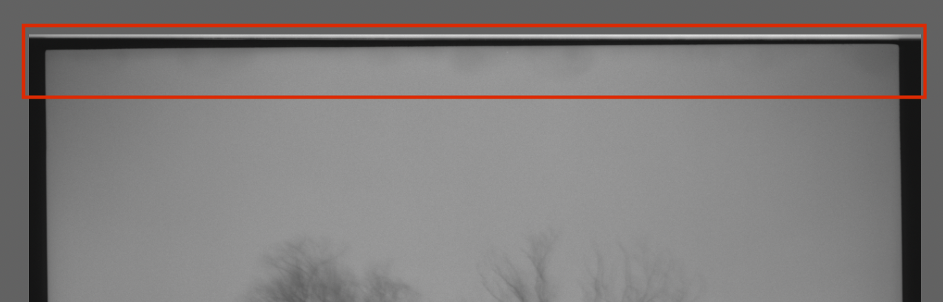

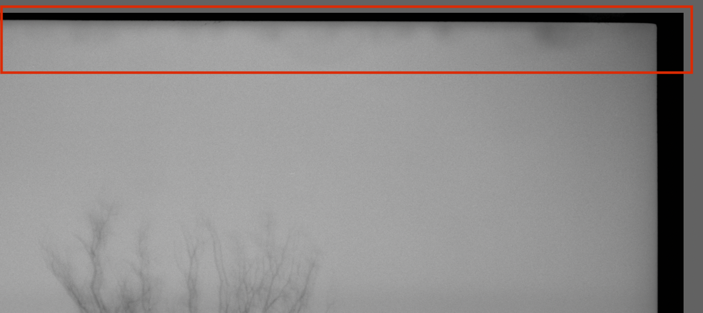

Processing film in my darkroom I'm getting dark blurry spots along the edge of my negatives, which can be seen in the attached scans.
It is only along the edge of the negatives, never in the middle. It is very visible in the part of the frame against a light background such as a clear sky, as in the the attached examples.
They are blurry, cloudy spots. Always dark and always random. Not every frame from every roll has them.
Appears on Tri-X and HP5 both so isn't film-related.

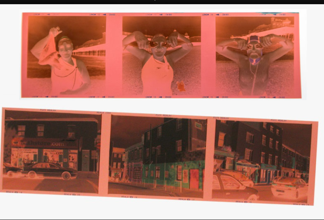

FWIW, it makes it much easier for us to help with issues like this if you show us backlit negatives with the film edges and space between the frames visible.
Showing positive scans introduces a whole lot of unwanted variables.
Something like this excellent example, supplied by member foc:
