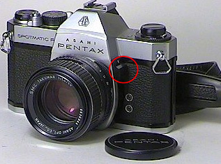

Trask, there is no meter switch on these camera.
Trask
Oct 23, 2005
1,926
Virginia (northern)
Hmm...if it's Spotmatic F, I believe it does have a meter switch. It should be right where the red circle indicates....:smile:
As far as I can tell that's for stop down metering, and it operates the pusher at the bottom of the mirror box, which is quite clear of the mirror. The meter is always on. After read your first post I had to find out what that switch did, and that's what led me to getting the meter working. But operating that switch does not cause anything I can see in the mirror box to jam the mirror up. Do appreciate your help.

It's very possible that my Spotmatic is an older model and they changed the internals. In my camera, if you remove the lens, look into the mirror box with the mirror in the normal down position, on the right-hand side of the box up near the focusing screen is a small protrusion. When I push down on the meter switch, this cause the protrusion be stick out. When the exposure is made, the mirror swings up and strikes the protruding device just as it reaches max elevation, and the meter switch is released to return to its original position. As I say, mine is probably an older model.
The Spotmatic F was the first Pentax with Full Aperture metering with the SMC Takumar's, Older Takumars or other screw mont lenses needed to be stoppered down using that switch in the old way.

As far as I can tell that's for stop down metering, and it operates the pusher at the bottom of the mirror box.
I also think that this stop down lever turns on the meter too. I'm sure it does on my Spotmatic. Don't know about the 'F' though.
Steve.
That is good to know. This camera is brand new to me and I could see no way to turn on the meter. The manual on Mike Butkus' site states, "Remove the lens cap. Now the shutter circuit is on," which just does not make sense to me.
I wouldn't take my word for it that the stop down switch turns on the meter. I just think it does and I'm sure I have read that it does somewhere.
However on this page: http://www.butkus.org/chinon/pentax/pentax_spotmatic/pentax_spotmatic.htm
Is the Butkus site with the Spotmatic F and it refers to the switch as a meter switch, not a stop down lever. This is because the F does not stop down the lens to meter but meters at full aperture. Therefore, it can only turn the meter on.
4 TURN ON LIGHT METER SWITCH.
Push up the switch button with your thumb, and the small window on the switch button will turn to red indicating that the meter is switched on. Through the viewfinder, you will observe the movement of the meters needle on the right side of the ground glass. Be sure to turn off the meters switch when not actually taking readings
However, that remove the lens cap meter turn on method is correct for the Pentax K1000 (I think).
Steve.

I've had a Spotmatic F for about a year now, and my research and experience is that the meter is turned on and off by removing and replacing the lens cap. The switch is for use with older Takumar and other screwmount lenses that need to be stopped down to engage the meter. The SMC Takumar lenses work at open aperture. Also, as I understand it, the Spotmatic F has a bridge circuit and can accept modern 1.5v batteries and adjust to the voltage difference for proper metering. I am not an expert, but from use and reading others, this is what I have come to understand.
You could be right but the part in the manual about checking the battery suggests otherwise:
How to check it
1. Set the shutter speed dial to B (bulb) position.
2. Turn the ASA dial to ASA 100.
3. Push the meter switch to "on" position.
Look at the meters needle through the viewfinder. If the needle rapidly drops, the meter battery has sufficient capacity; if it does not, replace the mercury battery.
Just stopping down the lens would not have this effect.
EDIT: I just found this which also suggests a switch: http://forum.mflenses.com/userpix/277_Spotmatic_ligth_meter_schematic_1.jpg

You're correct Steve, what I mean to say is that for lenses other than the SMC Takumars (which work automatically), the switch needs to be pushed up to engage the meter. The switch in effect stops down the aperture and turns on the meter.
I have 2 Yashinon lenses which require the switch in the up position to activate the meter.
I focus with the switch off and meter with the switch on.
