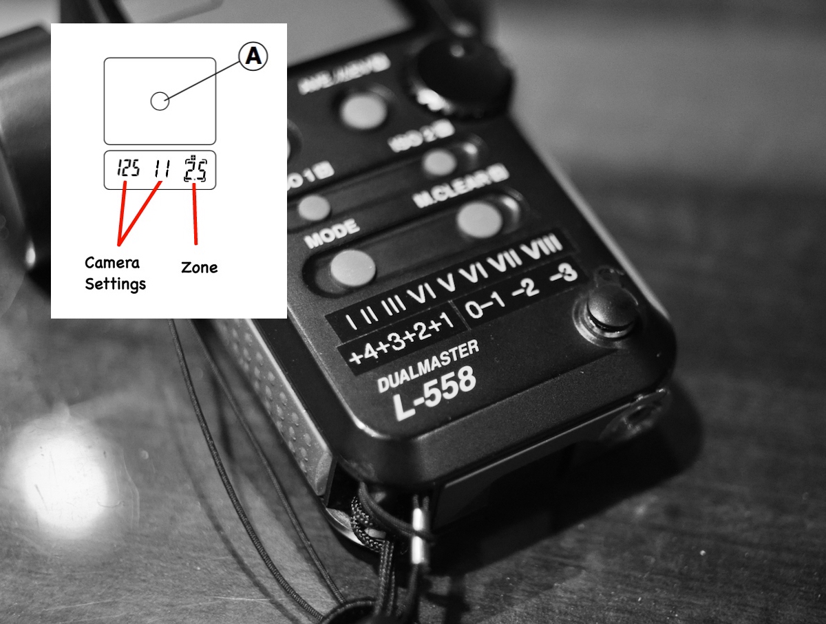

For 25 years I used a 6 degree VIEW METER (Sekonic L206) as I felt it better to sample an area with an assortment of low zones, setting the cluster of zones around 3 or 4. Also, because, for my typical subject matter, a 1-degree spot is not narrow enough.
Having posted that I did get a L558 a few years ago and use the 1-degree spot presently, though still sampling a range of low zones around 2.5.
The "Zone Sticker" shows the common Zones in Roman numerals compared to the meter's representation of that zone.
