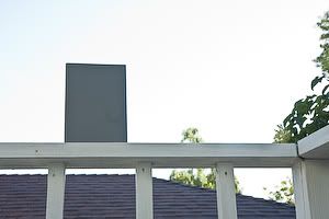

If you rely upon matrix metering, you can get this shot of an 18% gray card which is overwhelmed by the brightness of the sky and the gray card underexposed...
But if you spotmeter the 18% gray card, you get the shot exposed like this, showing the card at its inherent brightness...
