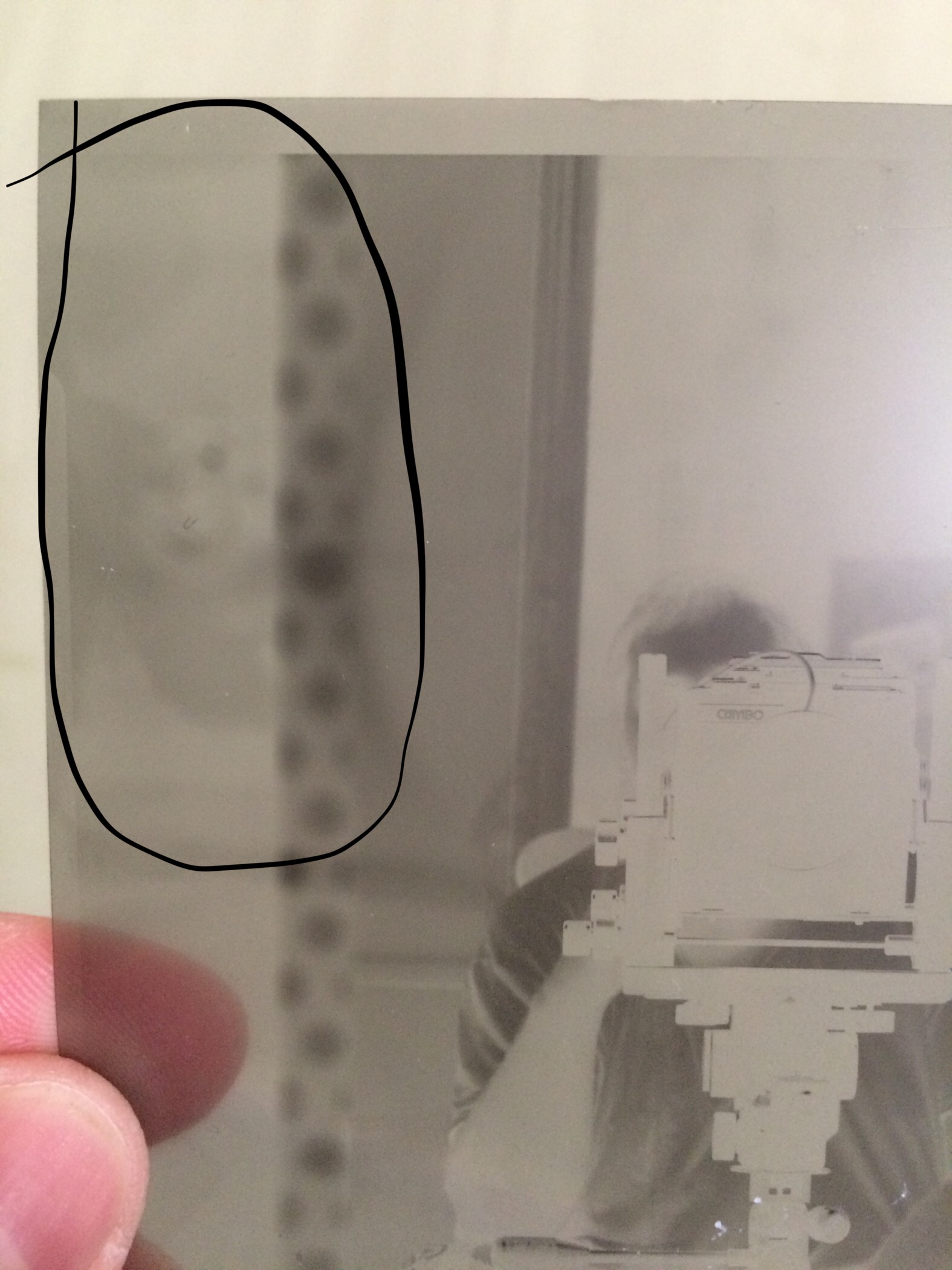

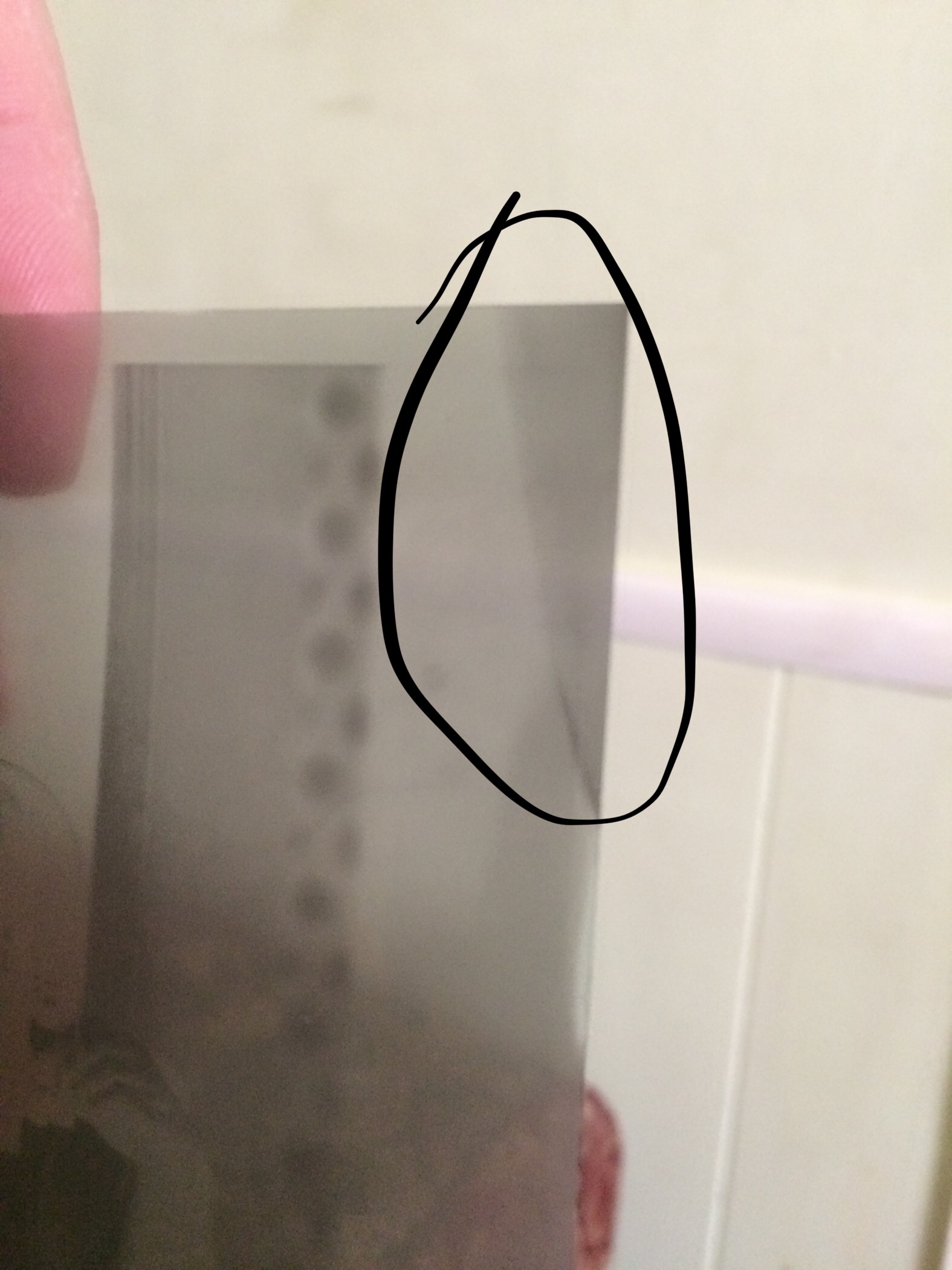

So I developed my first sheets of 4x5 last night. I first found out after they were done that I needed to clean out the film holders. I’ll fix that. They were covered in dust. Second...I circled a couple areas...what is this from? My thought was not enough chemical to cover the negatives...I used 500ml in a small Paterson tank. Ignore what looks like polka dots...just the circle area. Oh I used Arista developer

Odd....the first looks like some kind of double exposure, and the second possible faint light fogging. Was the film fresh ?
You can check the solution requirements - just put 500ml in the tank and measure the depth with a ruler., and compare it with the film dimensions. Usually insufficient chemistry or a slipped sheet leaves a band across the film. Localized marks can come from residual chemistry on the film before the developer (not with clean, dry tanks). Sometimes touching the film surface with sweaty finders can delay take up of developer. Work out how the sheets were in the tank. That helps decide if the processing was at fault.

Did you prewet the film before developing?
The triangular spot looks like fogging to me. Are you seeing this with just one sheet, or multiple sheets?
To my eyes the first looks like a double exposure, I am certain that I can see another exposure of a figre there, The second looks to me as if there was not enough developer for the film.
I think there's a mirror in that one.
The first neg looks like uneven development to me. Maybe that spot on the film got wet or contaminated before the developer hit it? The stripe on the second neg looks like fogging from exposure to light.

FWIW, not enough developer results in a lighter stripe (less development) at the top of the neg, not a darker area like you have. Ignore the posts that suggest the stripe is due to not enough developer.
