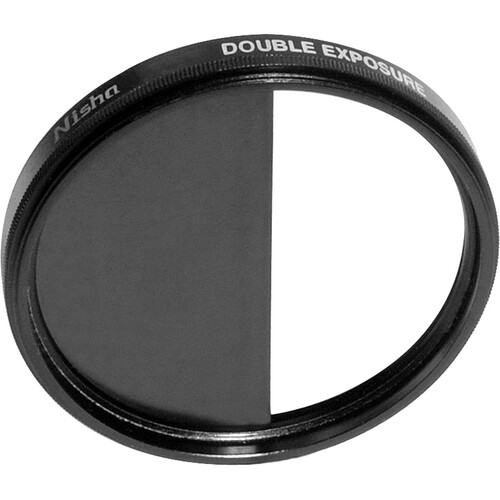

I'm wondering if it's possible to buy a proper split image filter designed for accuracy? In this video this guy has made something similar to what I'm looking for.
However, for what I want to try and achieve, I really need it to be dead accurate when you rotate it for the second exposure, otherwise there will be a visable line in the photo.
What I was hoping to do was to go back to a tube station and do this photo again, but try and achieve the same effect all analogue and straight out of the camera. I'd need a split image filter and probably one that clicks in place so you know you have it on the other half of the frame exactly. Then I can have the camera on a sturdy tripod, very carefully move the filter to the other side, wait for a second train and expose for the same amount of time at the same aperture.
Shooting at f/11 with an ultra-wide angle lens there wont be that much margin for error. Does anyone make such a filter, because I'm struggling to find one.

You can search for Double Exposure Filter in Google and you should get some results (depending on where you are located)
I got the following:
https://www.bhphotovideo.com/c/product/1416568-REG/nisha_de67_67mm_double_exposure_attachment.html
https://www.ebay.com/itm/2010904568...VY8PF2iboZ65/4xZx2cVuqXerfc=|tkp:BFBMqILu3sRg

I won't repeat the suggestions for getting the line accurate, but I will mention that diffusing the line means as little DOF as possible. The line will be more apparent as you stop down and as the angle of view increases -- so use as long a lens as possible, and as wide an aperture as possible.
Sonia double-exposure filters have a handle -- like some PL filters -- that might help:
https://www.ebay.com/itm/165595933354

The Kood one looks like it might have clicks for accuracy however if it's on a Cokin P mount I'd have to be really careful not to nudge that.
As the parting line between the two shots doesn't always pass through the middle of the image, nor is it always straight, I don't see much utility in the pre-made masks.
