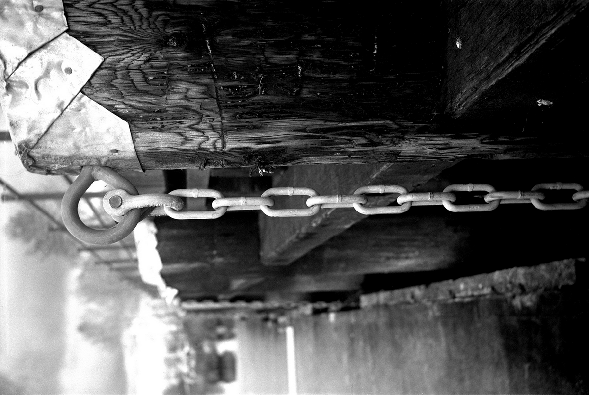

For some negatives, where it is difficult to assess the negative without doing a bit of testing, I do use the full 0 and 5 method - usually in that order, but sometimes in reverse order.
Most of the time though I can assess the negative and use a low-moderate contrast setting for the base exposure strip, and the 5 filter for the second test strip.
Except for those negatives that demand the approach in reverse, where it is best to start with a high-moderate setting for the base exposure strip, and a 0 for second test strip.
This negative is one that benefited from the latter approach - and yes it has been turned sideways for display:
Is that because..... deciding to start with the 5 filter.....there is so much Shadow/Dark areas and a lot less highlights.?
Or is there some other reason.?
That is most of it.
My approach to that particular subject was that I wanted to emphasize and delineate most of all the the dark areas. I was always almost uninterested in the out of focus highlights in the background. So I started with the equivalent to 4 (the highest available on my Ilford Multigrade light source) and keyed to those tones when evaluating my initial test strip. It was only after I was satisfied with them that I started testing with the equivalent to 1 (the lowest available on my Ilford Multigrade light source) to bring in detail in the chain. It was a while ago, but I believe I also did some high contrast setting burning on the chain - burning highlights with the high contrast filtration is a very effective and relatively under-used technique.
For most images, the mid-tones and highlights are far more important, so it is best to determine the low contrast exposure first. That will give you the majority of your image anyways.
