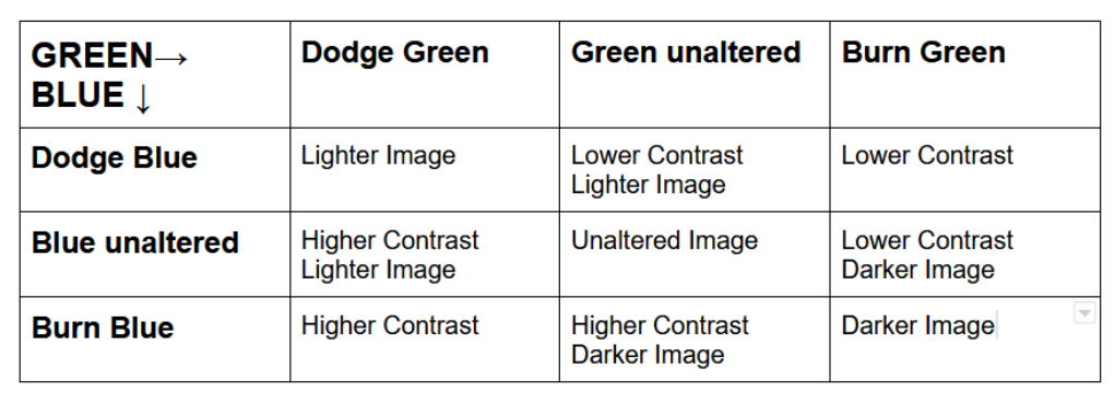

I am also making an Arduino based controller for my home made LED head. I also have a light sensor that I can run around on the easel to analyze the contrast in the negative. This is actually my third generation version, the earlier versions were all analog based. Adding a microprocessor opens up a lot of flexibility.
Yes, adding Green will lower the contrast, and dodging Blue will also lower the contrast. Both methods will also alter the exposure so the area should be lighter or darker as well.
It looks a bit like this:
So, in your question dodging blue with green unaltered or burning green with blue unaltered both will lower contrast. But they will also have the side effect of changing the overall density of the area.
