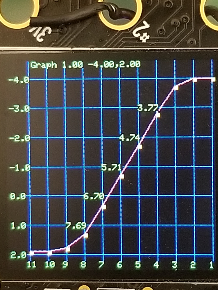

Your table reminds me of the grade table in my controller, which allows you to change grades without affecting exposure-time. It maintains a selected tone, which is shadow, mid-tone, or skin-tone. The software interpolates between table entries, thus offering you fractional grades. I find this smart-grade-change feature very handy, and I used it last night to switch from grade 2 to 5 while preserving mid-tones. You're welcome to the source-code if interested.

...the grade table in my controller, which allows you to change grades without affecting exposure-time. It maintains a selected tone, which is shadow, mid-tone, or skin-tone.
There is a method for split grade that takes the black/deep shadow / white/specular highlight meter readings and comes up with the right blue and green exposures. Paper characterization for split grade is easy as compared to characterizing a paper for 12 contrast grades.
Inputting the meter readings for black and white points, with a few stored paper constants, should allow your head to come up with the right contrast and exposure.

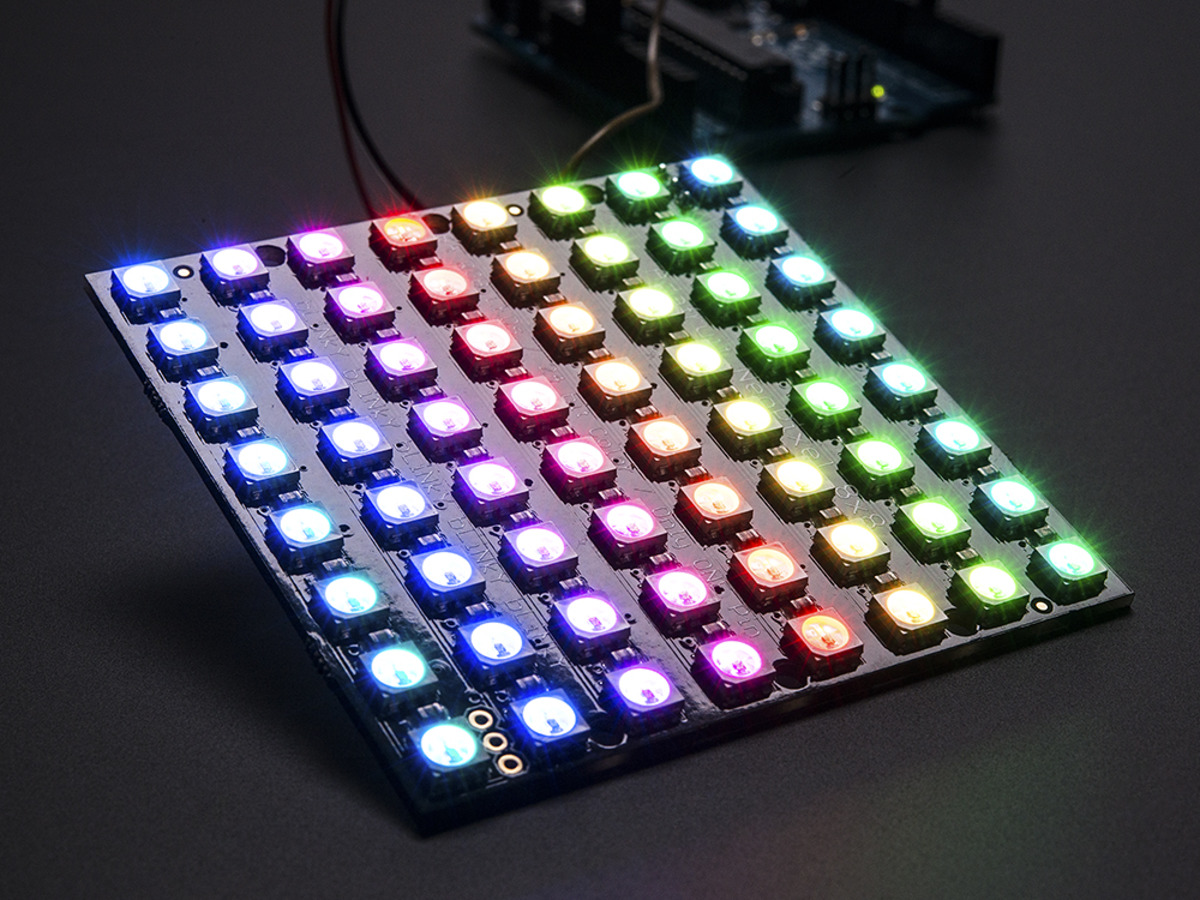

Yes, R100 is obviously showing that the LED's have the wrong spectrum. The LED's I chose are called neopixels, and they are actually three LED's in one package that is controlled via a digital input signal. The LED's can be attenuated and selected using the digital signal. They are actually meant for display signs and such. Which probably explains why they have so much Green in the blue. I selected this set of neopixels because I can adjust the brilliance of each of the 64 LED's separately. I had read a bit about other people using LED's and having to work pretty hard to get the illumination even. So this seemed like a pretty good solution. I have actually tuned them so that the image on the easel is pretty even. So that part was a success. So now you can understand why I can't just swap out one blue LED for another. That is why I had to add UV LED's (probably could have used royal blue LED's and that would have made life much easier).
The UV LED's were difficult to put in and get the illumination even. First I had to worry about blocking the neopixels, so the UV LED's had to be placed in odd locations. Second I had to tune the system with various resistors to get the illumination even. And to make it even worse, my light sensor is deliberately designed to not respond to the UV light. So in order to evaluate it, I had to put a fluorescent material over my light sensor to see what was going on.
See the picture of the neopixels here
