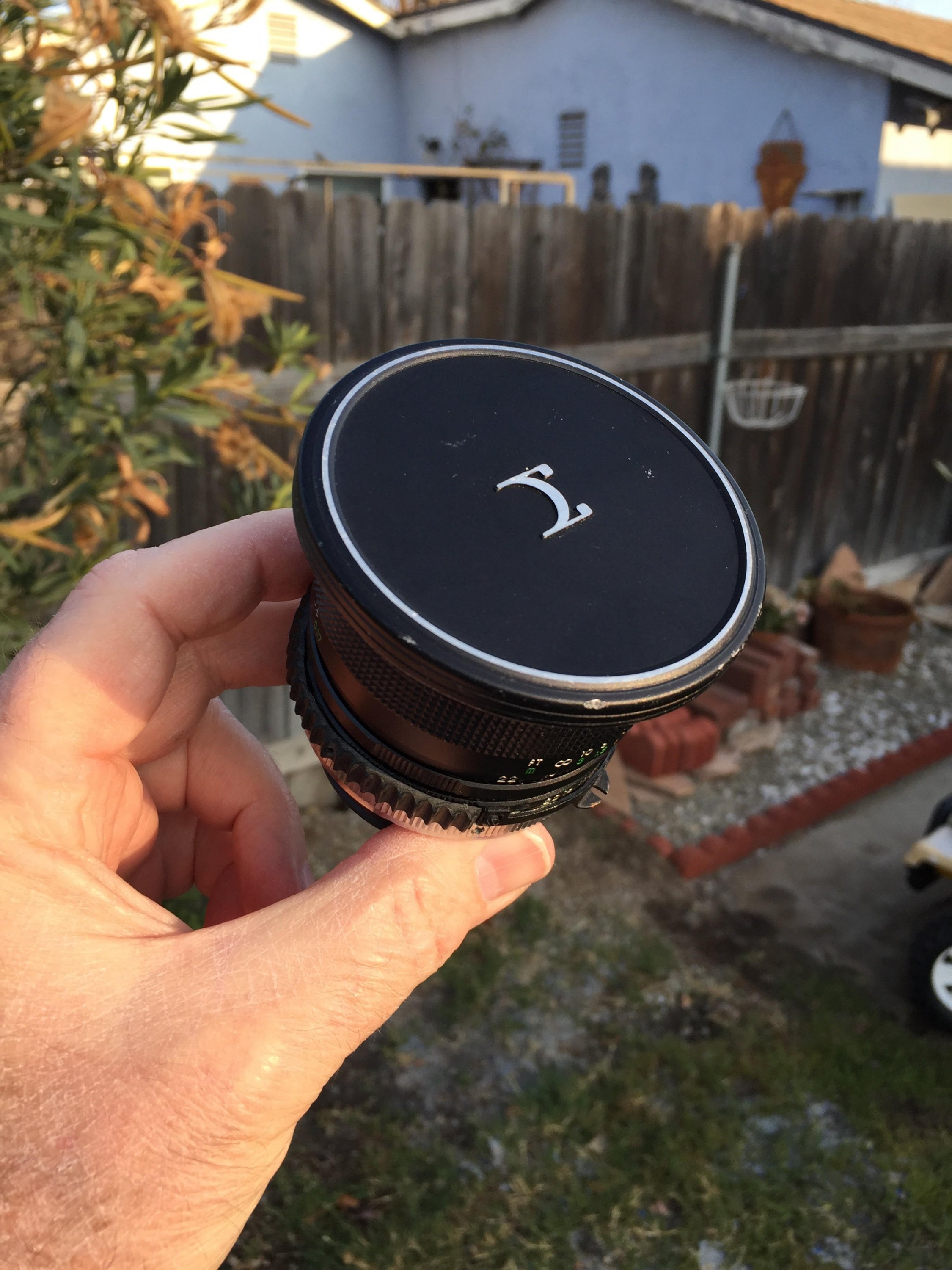

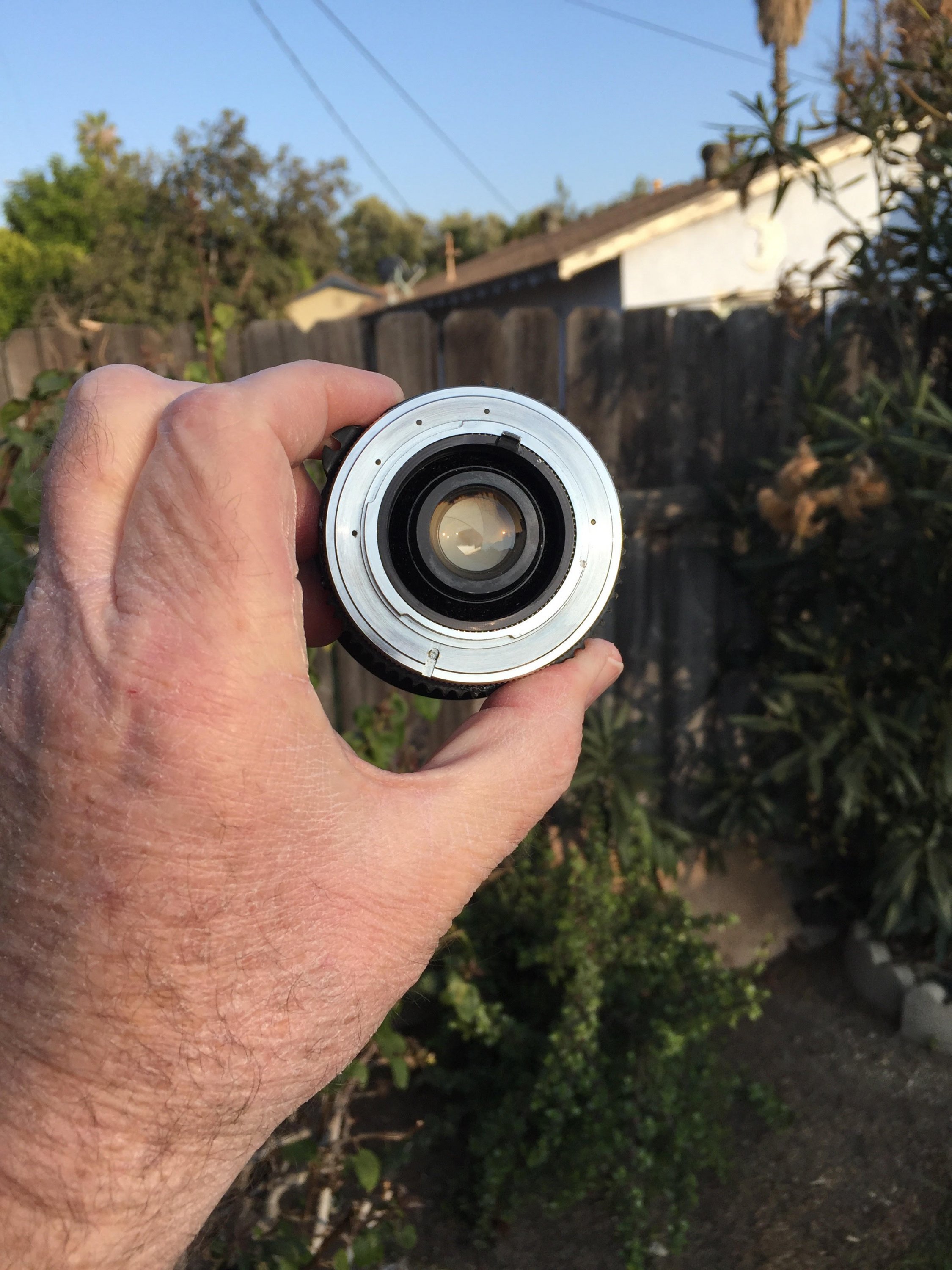

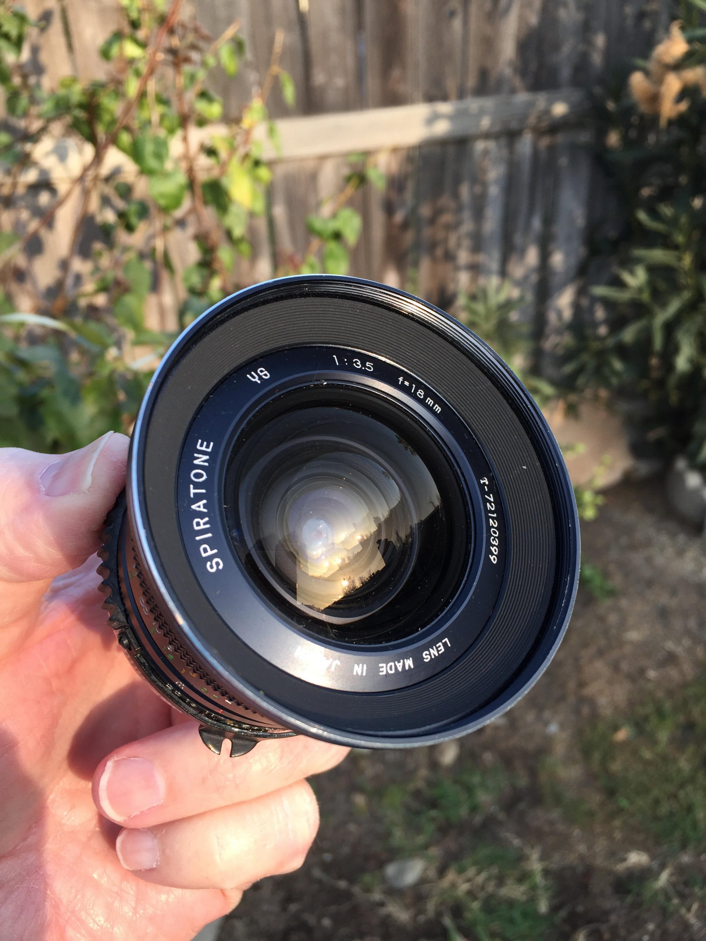

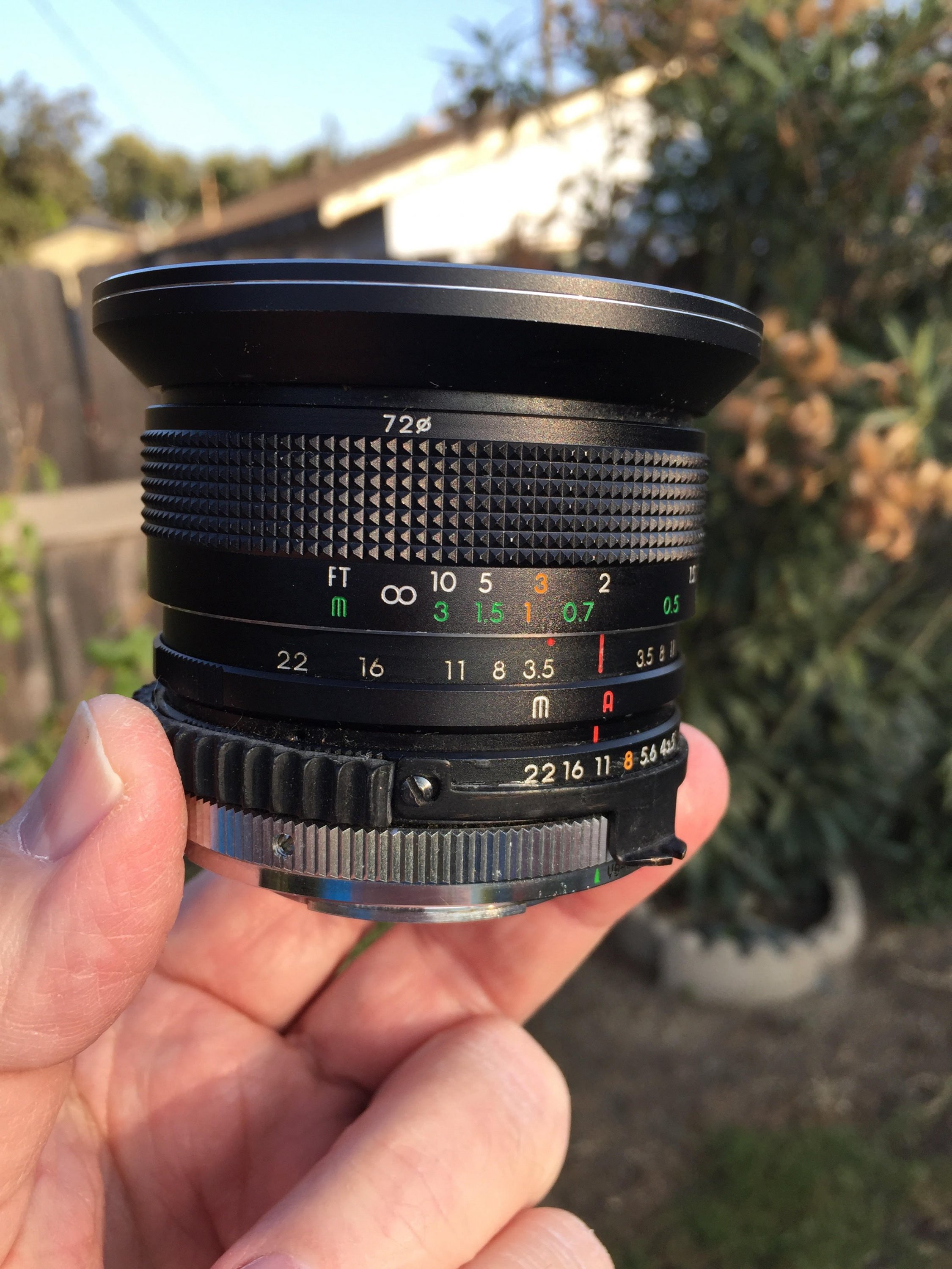

I am selling my Spiratone 18mm F3.5 for Nikon F mount (Non-AI). The lens is in good used condition with clean, clear, scratch-free glass. The iris action is snappy and correct. All other functions work properly.
The lens comes with caps. The front cap is marked with the greek letter "Sigma", possibly denoting this lens was made my Sigma (Japan), but I am not sure. Spiratone was known for re-branding many fine quality Japanese made lenses.
Price: $75 plus shipping

I just noticed this lens has a YS mount on it (for Nikon F), so that it can actually be used on almost any camera ever made that accepts interchangeable lenses with the appropriate adapter. For some camera mounts automatic iris control is also provided, and as well as coupling to internal meters. The details are a little involved, but covered nicely at this link:
https://www.butkus.org/chinon/y-s_mount/ys.htm
Something not covered in the YS mount instruction manual reproduced by Butkus is that YS mounts have the same length as T2 mounts (AKA T-mounts). Thus, if you want to use this non-AI Nikon YS lens with a Minolta, Canon, Miranda, or even Leicaflex SLR and are unable to source an appropriate YS adapter (one comes up for sale every now and then on eBay, and one of the YS lenses I got came with a Leicaflex adapter), replacing the YS adapter with a T-mount will enable use of the lens with preset diaphragm operation.
I acquired a few YS system lenses over the years sold as M42 screw mount, but those who used the lenses tthat way had to be dissatisfied with their results. While the basic YS lens has a single pin auto diaphragm mechanism, and 42 mm ear thread, its a 0.75 mm pitch thread, not the 1.0 mm pitch of the M42 camera mount. Without either YS or T2 adapter, the lens won't be properly mounted on the camera, and the back focus of the combination will be incorrect.
