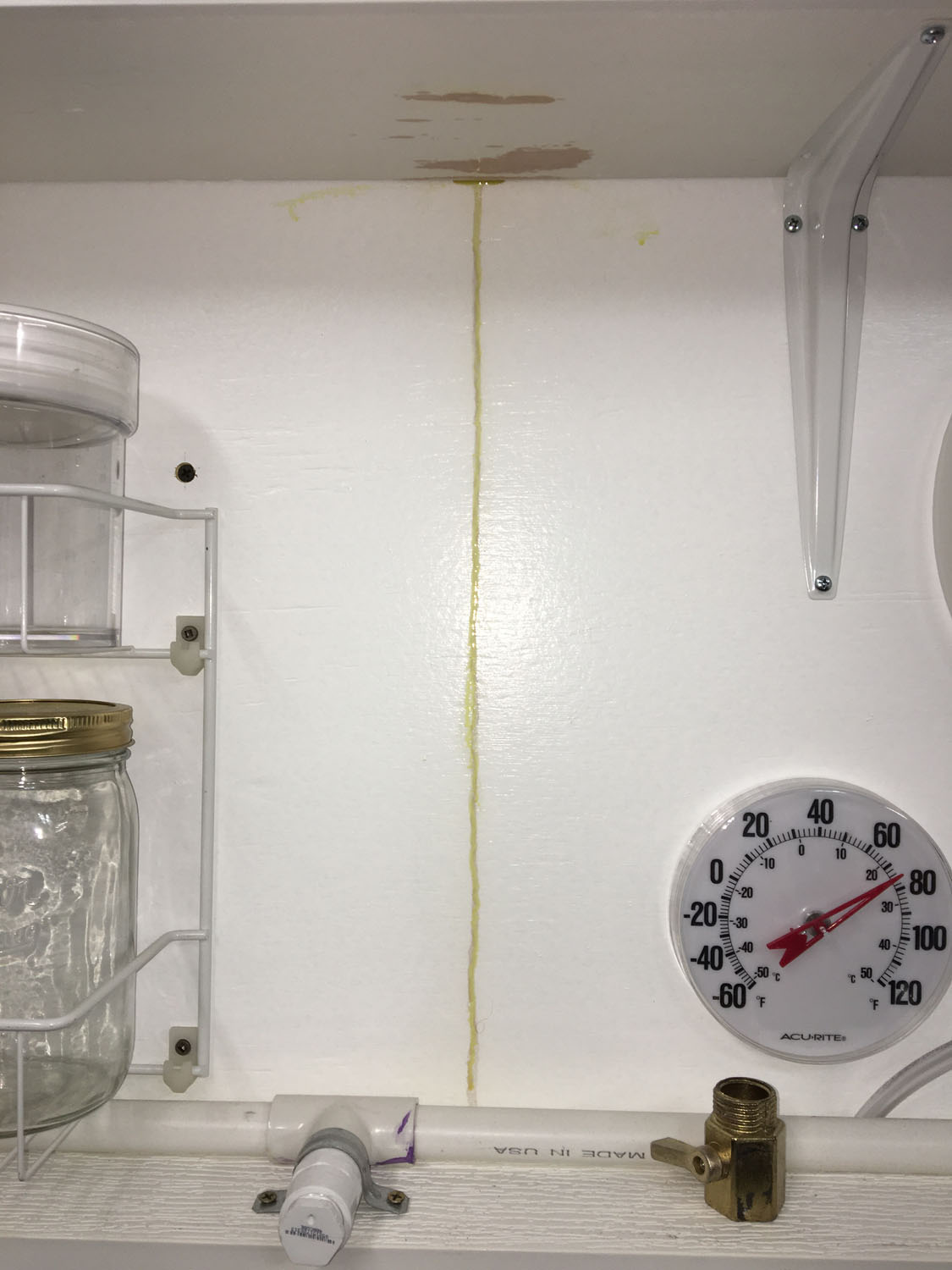

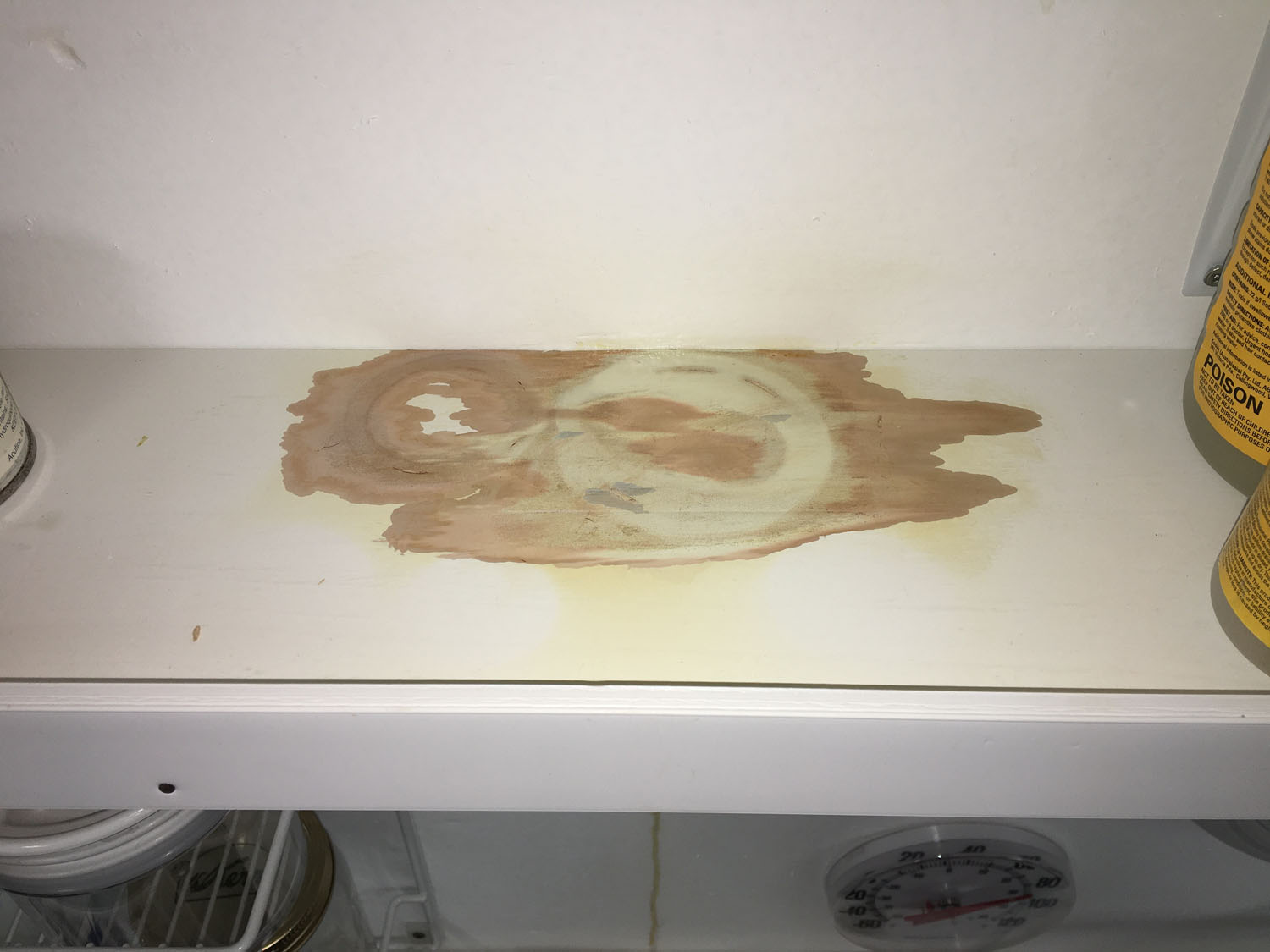

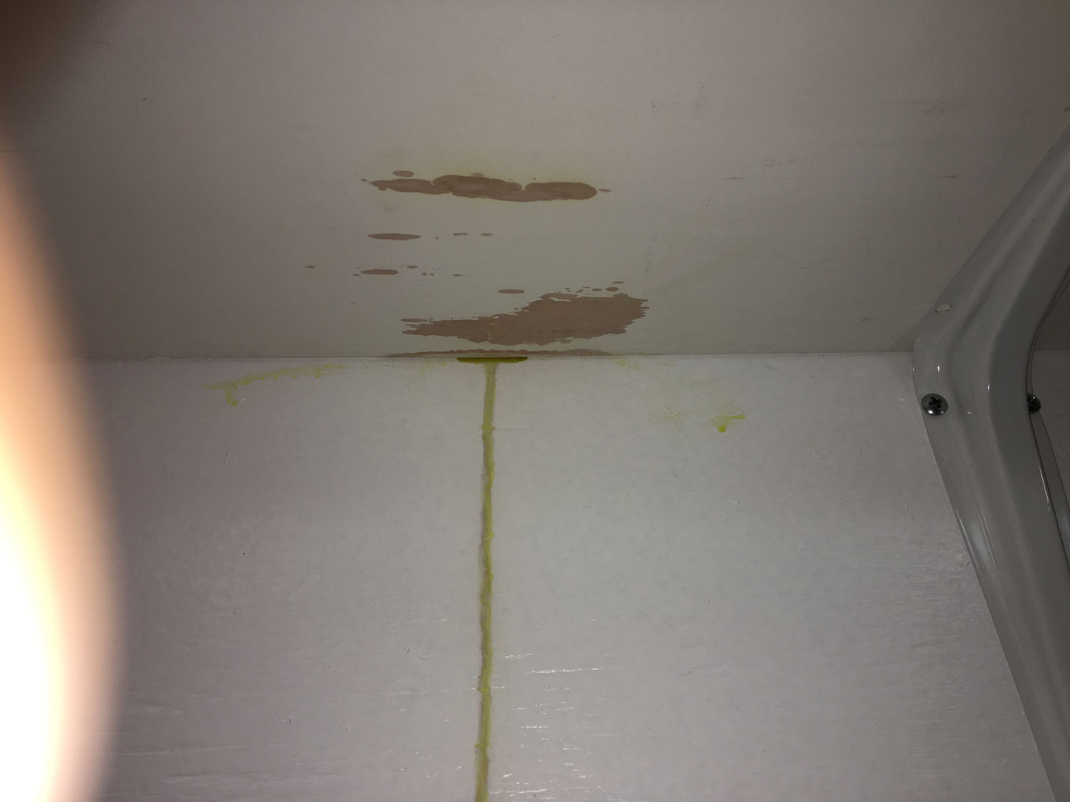

Found a brown streak from my chemical shelf down to a sink in the darkroom. Discovered that an old (2008ish) bottle of Kodak HC110 has cracked and some of the contents leaked out. The good news is that HC110 is a syrup and it didn’t just all pour out; and, that what did leak ran down the false wall (installed to hold up all sorts of shelves and darkroom do-dads) and into one of the sinks. Minimal harm done.
The bad news, the remaining developer went to disposal; and the shelf where it was sitting is pretty stained. The stain goes all the way through the wood and shows on the bottom. The shelf is a standard pine 1x6, painted with latex. The stains are minimal in the larger scheme of things, and do not bother me. (It’s a darkroom!)
However, my question is: When this stain dries, is the wood okay? Will it eventually do more damage to the wood? Should I replace the shelf? When it dries, will it be stable? (And, no doubt, get darker over time.)

I would wash it several times over a week with the hottest water you can use and some Trisodium Phosphate TSP, which should take up the HC110 and most of the remaining paint around the stain (both sides).
Let it dry for a full week and then put a couple of coats of "Kills" or other stain concealer paint and then repaint the shelf. The wood will probably be fine...

In spite of the photos, I have a hard time thinking the hc-110 went through the wood. I'm thinking capillary action. The fact that there are "gaps" in the staining on the bottom is due to where it just happened to pool longer (or thinner paint). I think Kino's suggestion is good. The paint product is call "Kilz" and will be found in the store with other paint primers.
Thanks. I am familiar with Kilz; have used it a lot. After some thought and research, I can replace the shelf with a new, painted board for a cost of $12. That would be much less labor and mess than the cleaning and repainting. Plus, I will bet that by the time I purchase TSP, Kilz, and new paint, it will add up to at least $12. :wondering:

As for Doremus' suggestion, I used to keep several gallon jugs of distilled water "on hand" (from the grocer) and I learned to keep those in spill proof storage, as those jugs are not designed to hold up very long. I have three of those big, gray busing trays that they use in restaurants when clearing tables. I think I'll just start keeping liquid stock in those on the floor under the sinks. As for the shelf, the easiest and cheapest thing is to simply replace it.
