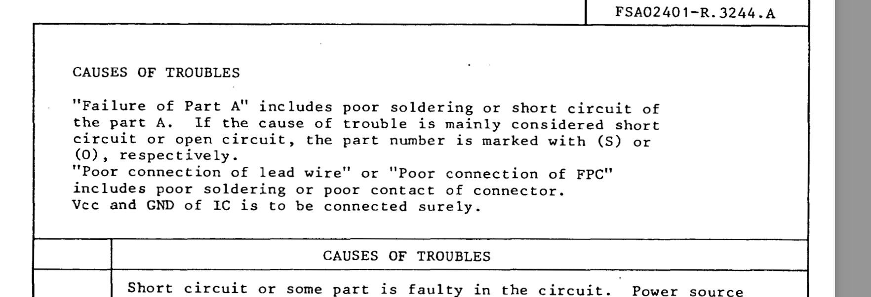

Do you know this site? The SB-28 service manual is there. Also, the SB-24 manual has the troubleshooting algorithm (below) which was not duplicated in the SB-28 service manual.

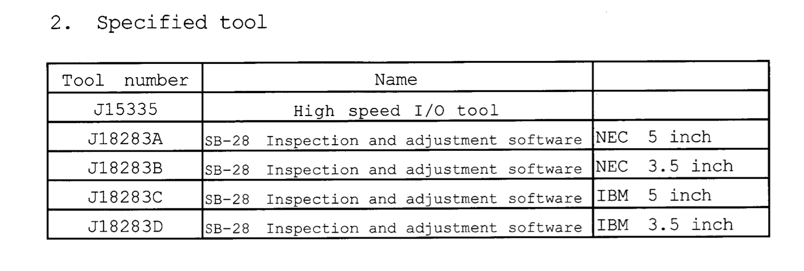

We had a thread on this recently, but those Nikon service manuals are good up to the point where you need to put the 5" floppy in your computer to adjust the camera or flash...:smile:
Great, thanks - no, I didn't. I have very little Nikon gear, so I guess I never looked for it. It's great though!
LOL! I can try, but I'm not sure it'll spin up in the DVD drive...
