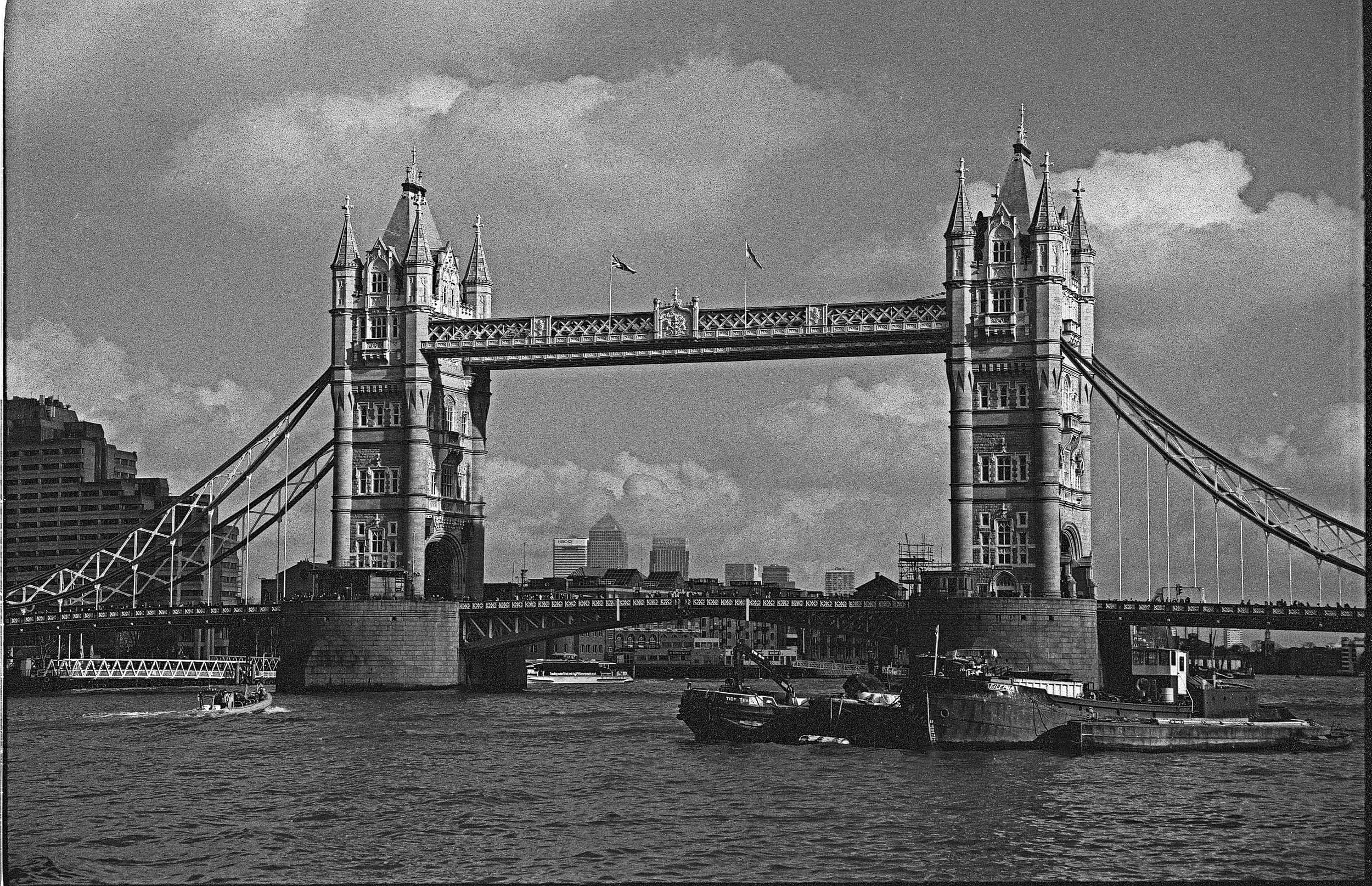

I have not measured the speed increase compared to D-76 accurately but the attached pics on APX 100 exposed at EI=200 (average metering) show there is an increase.

I too expected a shorter development time.I have no densitometer but the contrast looks slightly less than what I get with Xtol and was a surprise and hard to explain.

The pics were taken with an orange filter and I had to increase the contrast after scanning to get blacks. I doubt there is anything particularly unusual about the tonality of W3.
Yes it is grainy and unless this is wanted Xtol pushing would probably be better. There are occasions where it is convenient to shoot 100 box speed film at EI=200.
The results seem very good to me. I like the tonality....but, I think the effect due to the orange filter is the much larger than any effect due to the developer.
I am very curious about the fog levels. Based upon my experiments with similar concoctions (yes, Gainer influenced many of us), I would expect considerable fog.

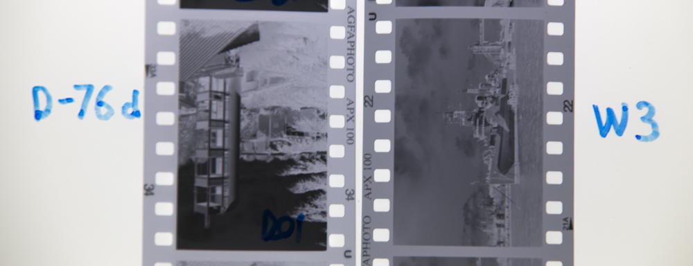

What do you observe with respect to fog levels compared to D76?
It is, indeed, a very grainy developer. Some may be interested in it just for that reason. I'm not real fond of its rather brooding tonality, but that may be an exposure issue.
Hi Brad,
Hope you can get an idea of the fog levels with D-76d EI=100 and W3 EI=200 from the attached pics on a lightbox.
Interesting....and about what I expected. There is noticibly more fog than with D76 but, it does seem manageable. It might be interesting to see what effect the addition of some benzotriazole (spelling?) or KBr has on the fog level.

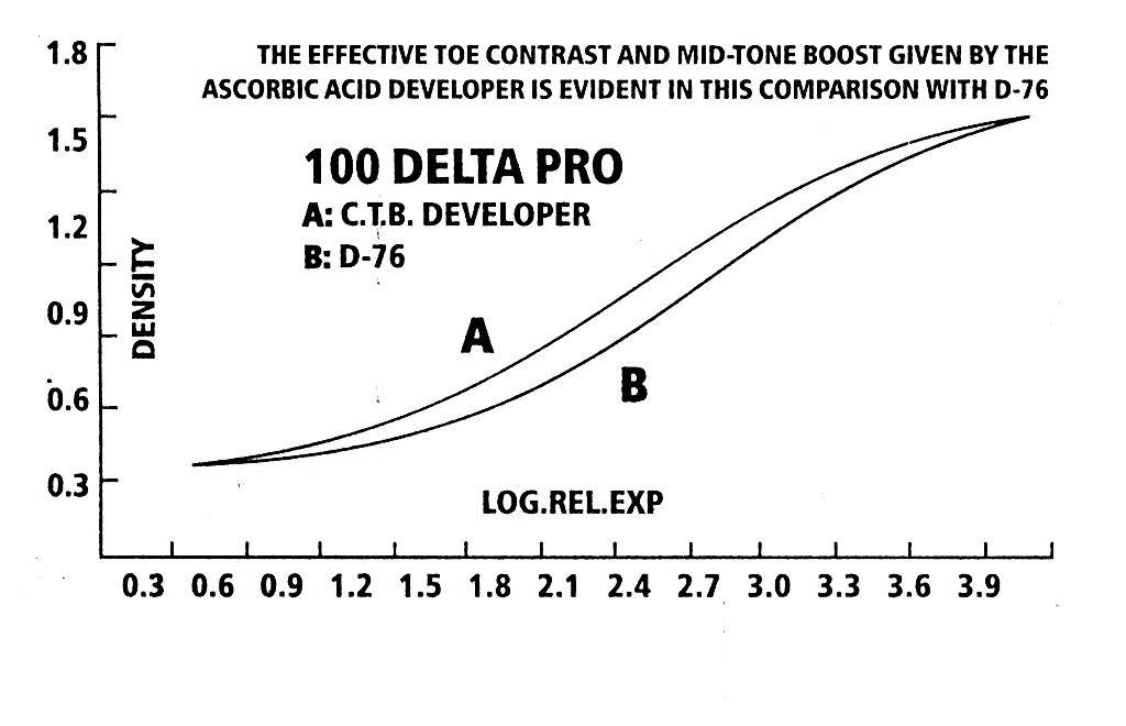

I have taken the liberty of attaching a D-log E curve from the British Journal of Photography 10 Nov 1999, article reporting work by C T Blood.
CTB Developer-working Solution:
Ascorbic Acid................1g/L
Phenidone...................0.1g/L
Sodium Metaborate......8.75g/L
pH 9.9-10
Develop Delta 100 10-11 min 20C
The writer claims Delta 100 can be exposed at EI up to 250-320 ,Pan F at EI 125-160 and Delta 400 up to EI 800.
This suggests that it might be worthwhile to test W3 at higher dilution to see if it can give anything like these results.
I will get some Delta 100 and try W3 at 1+19.
