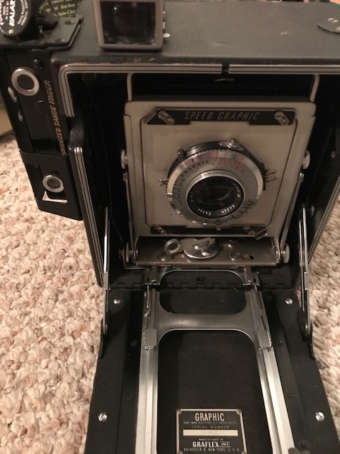

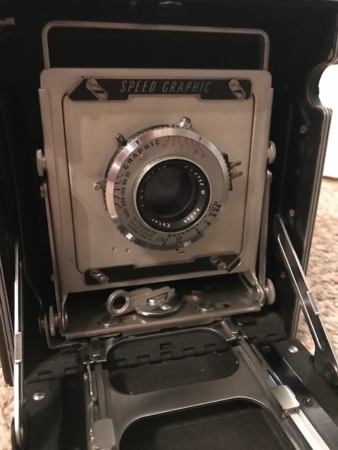

I recently bought a 4x5 and am curious about it. It says "speed Graphic" on the front and has a Kodak ektar lens as well as a graflok back but is missing a focal plane shutter so confused about it. Is it possibly a parts camera or maybe the focal plane shutter was removed? Any idea. Thanks!

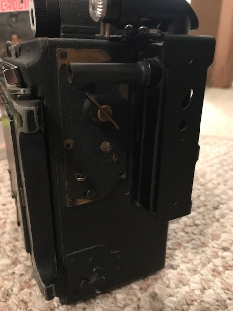

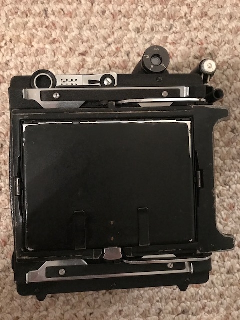

Looks like an Anniversary Graphic that was upgraded with a Graflok back. The focal plane shutter appears to have been removed for whatever reason - maybe because it was nonfunctional and coukd not be repaired or maybe to lighten the camera a bit.
No, definitely a Pacemaker Speed Graphic. It has a silver face.
Your probably right. My mistake. I was looking for the F/R switch, which this does not appear to have. And the board doesn't appear to be a wood "C" board.
It's an Anniversary body due to the shutter and strap fittings, but with a Pacemaker front standard and later Graflok back. I have the parts to do the same :D

That's what I was wondering because I used to have an anniversary and looked similar. You've been helping me out a ton today. Haha. Would there be any issues I should look for to make sure it's working properly since it's several parts outside of just testing it? The Graflock back seems a tiny bit loose but when I put a film holder in it was perfect. Hopefully can shoot a few sheets this week. Trying to dive back into large format after a brief stint earlier.
917xxx dates to mid year 1956. Bed, bellows, front standard, optical view finder, and graflok back are of said camera mated to an Anniversary Speed body with the Focal plane Shutter removed. With the front standard fully retracted read and post the serial number ink stamped on the bottom side of the camera top, handle side.
