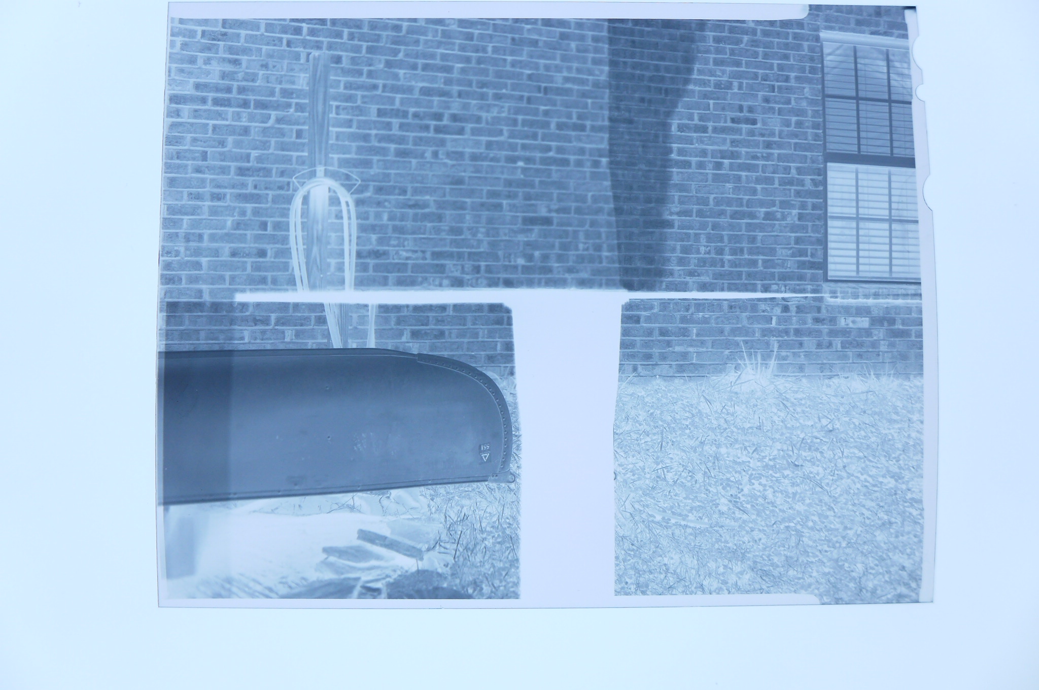

I got around to testing the speeds of my newly repaired rear curtain using the methods suggested by several here.
I took four exposures on one sheet of HP5+ at box speed, and developed in HC110B for five minutes.
I am really pleased with the results. The images are a little underexposed, but much closer than I could have hoped for the first test, and consistent across the apertures.
I tested at the lowest tension, and using A, B, C and D curtain apertures. So the shutter speeds were 1/10, 1/70, 1/200, and 1/500.
Please give me your thoughts on the following:
1) Should I try and loosen the tension on this lowest setting to slow the curtain down a bit (and thereby bumping up exposure), or just work with it as is and adjust my exposure in the field?
2) This opens up barrel lenses to me, which is the biggest reason I wanted to get the curtain working (I am excited!). Can you make any suggestions on a cheap barrel lens to start off with?
Thanks again to everyone who has helped me with this project, and thank you yet again to John, who gave me this camera. I now have a fully functioning Speed Graphic with the bellows sealed, the rangefinder working, and the rear curtain working - all for free! I am in bliss!
EDIT: Oops - I meant to upload a pic of the negative. The top left is A, lower left is B, top right is C, and lower left is D. Ignore the motion blur from my bad technique.
I should mention that the lighting was VERY flat on this overcast day, and this entire scene only had two stops of range, excluding the black tarp in the bottom. But even the tarp only added one more stop. I feel like that tarp should have more detail with how I metered.

Testing with negative film is problematic because of its exposure latitude.
When I got my 2x3 Speed, I tested its curtain shutter with ISO 100 Ektachrome, did the equivalent of shooting test strips. Metered, set the aperture for 2 stops underexposure if the shutter speed was right, pulled the dark slide out a little, took a shot and the shutter speed being tested. Rewound (with dark slide in, of course), pulled the dark slide out two littles, repeated. Took five shots in all, I ended up with strips on the test tranny overexposed by 3, 2, 1, 0, -1 and -2 stops, could easily see which was right for the shutter speed set. Much to my surprise, all all speeds the 0 strip was best.

I am going to do the over- and under-exposure test you mentioned. I need to test the speeds when tensioned up, anyway. You have a good point that slide film would be a better test, but I won't be shooting slide film in this camera just yet, so I may put that off. I don't have any sheet slide film on hand.
Graflex FPS requirement for the initial tension is 1). With the curtain at O and tension on 1 the curtain should close and lock. Lock is the wind key will not turn opposite the wind arrow. This requirement should be true with the camera in any position, portrait with the shutter controls pointing down is the most strenuous on the curtain; 2). With the tension at its highest setting the curtain should wind to its smallest aperture.
When both are true then the shutter is properly tensioned and one should work with the speeds as they are or make a new tensioning spring and try again for table speeds.
There are two winding keys - one for the aperture on top and one for the tension spring on bottom (I know you know this, I'm just describing to make my question clear). The one on top works as you describe. When I was working on the camera, I had unscrewed the mounting plate for the bottom (tension) key, and it spun around a bit. I spun it back to what felt about right and put the mounting plate back. My question is whether I should loosen that spring one or two more turns to increase the exposure.
Forgive my rudimentary description - I am not good at this.
The wind key is the top key for the aperture. The bottom knob is the tension setting. You can experiment with lowering the initial tension ( tension 1 setting ) in 1/2 turn increments if you wish but I would only do it if the closing from O closes hard with the camera in portrait position.
