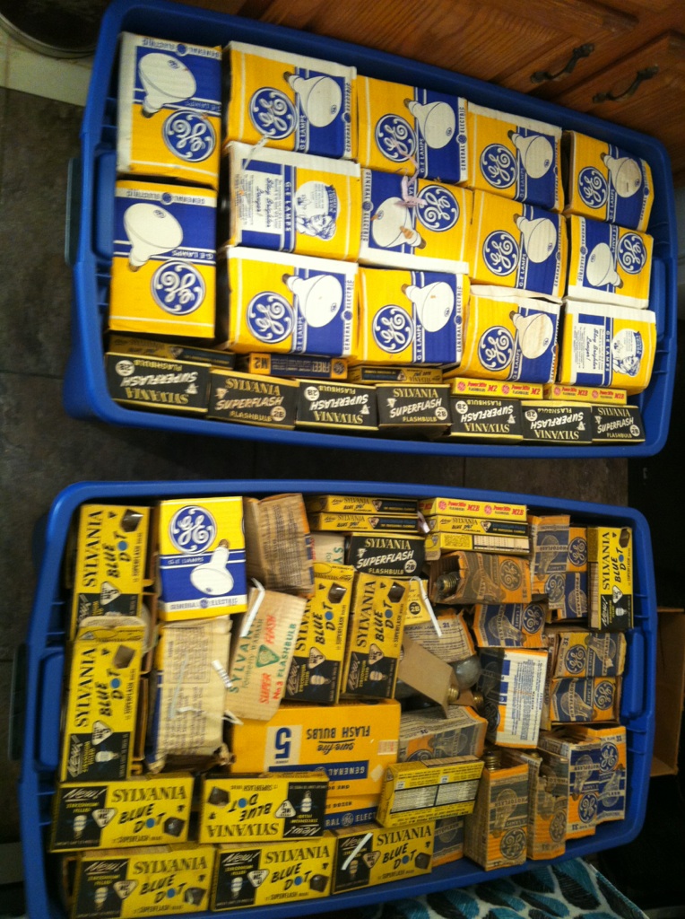

I have enough flashbulbs to last the rest of my life. Roughly 3,000 or so. Mostly edison base, with about 500-600 Press 25's & 5B's And 2 unopened cases of Bantaom 8's. I used about 100 or so a year, mostly when I want to try something different or have a style I want to mimic.
I have 4 more tupperware cases filled with bulbs.
nicholai
Jul 12, 2012
289
Denmark
Uh... I dunno what to say. I guess "holy shit" will suffice.
