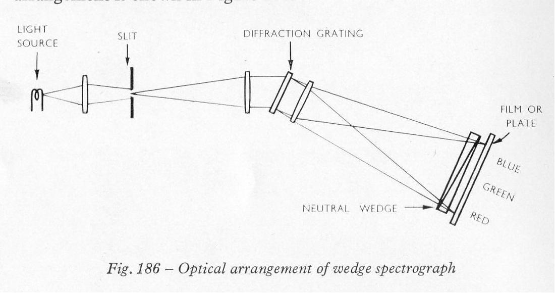

Thanks for your reply. Your answer inspired me and I found that I already had the answer in no less than three photography books (I should have looked before I posted!). One being the 1958 edition of the Ilford Manual of Photography. Attached is a scan from this excellent book showing a spectrograph. Baker also has construction details for one.

So let's break down what the optical path might look like. It's hard to tell from the diagrams what exactly is happening in the 3rd dimension.
So we have a light source and a lens (simple meniscus?) to concentrate the light onto a slit. The slit will presumably create a thin "bar" of light that next must go to a diffraction grating. I think the "science class" type gratings that are mounted in 35mm slides would be ideal, as has been noted above.
Now, does the angle of the grating affect how the light is diffracted, and how much it fans out?
How important is the collimator in front of the grating? It looks like the purpose of that is to get the light to come at it perfectly parallel. But wouldn't a horizontal bar of light (from the slit) hitting the grating still make a reasonable projection of the spectrum?
Then the diffracted beam of light encounters the step-wedge, placed in front of our test film.
What I'm having trouble imagining is the interaction between the projected spectrum and the step wedge. Most step wedges that we know are arranged in a long thin strip, not wider than a centimeter or two. How on earth are we supposed to project the spectrum onto this and achieve a 21-step gradation at all spectral frequencies? We need each spectral region (400, 500, 600, etc.) to go through the whole range of steps. This seems obviously impossible with the thin step wedges that we're all used to.
Now, Kirk, you say you have a spherical mirror with a grating in it; how would that design work? It sounds like that would be fundamentally different from the above diagram posted by Emulsion.

I'm convinced we can make something very inexpensively. All we're doing is projecting a spectrum onto a piece of film, through a step wedge. It's just a matter of buttoning it all up and working within some parameters.
First though, I think we really need to wrap our heads around the design and understand that (in 3 dimensions) more clearly. Hopefully some Q&A will get us there fairly quickly.

In my unit, it is a fully straight line path from the light to the "output". The monochromator has an opening and is box like with an opening on exactly the other side for the exit beam. There are probably many twists or turns inside the "black box" but I am loathe to open it. It works you see. So, what ain't broke, don't try to fix.

I'm gonna be thinking in terms of the above design (the diagram), with a simple halogen or tungsten bulb. It's the optical path that I really wanna get a grip on.

Your diagram scares me! "Simple" to you maybe. I'll bet you were one of those nine-year-olds who built his own rockits,radios and computers.

Well, Bill, I have posted a picture and a diagram here before. I tried and cannot find the picture I posted, but it was the one used in the book and I have "retired" them all since the book's completion. I can repeat the diagram here in text.
Constant voltage > Light > shutter > Monochromator > step wedge.
The input to the electronic shutter is a precise timer. The whole optical path is on a heavy metal plate to keep it in alignment. It is nothing fancy and could be cobbled together by anyone. A prism or diffraction grating could work. It is all straight line from one end to the other, and about the length of a counter top (~24") and about 10" wide.
