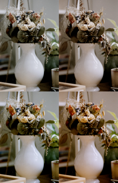

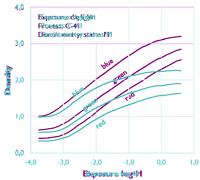

Orwo NC400. It's similar to NC500
Right, like peas in a pod, eh.
Magenta = NC500, cyan = NC400.
cool rather than warm
Depends on how you print/edit it. This is not baked into the film, contrary to other aspects of color rendition. Fidgeting a bit with the yellow filter dial makes a big difference and can make a supposedly 'warm' film print cool and vice versa. Because there's no 'warm' film. Saturated or contrasty, yes. Crossover, linearity etc - yes, that's inherent to the film, although even those aspects can be manipulated afterwards (especially in digital space).
Please tell me which film was used for the images below - and while you're at it, which one is the 'real' look of this film. To make it easier, I'll give away that it's either NC400 or NC500.
The NC films will have a few things in common that are inherent to the product. 'Warmth/coolness' is not one of them. And evidently, they respond very, dramatically different contrast-wise and also in terms of crossover behavior.
Interesting. My experience was probably due to the lab scans I got. I'll have to look more into it.
koraks
Nov 29, 2018
20,862
Europe
Yes, that's probably the main factor at work here - as it usually is. It's important to keep in mind that with CN film, what we're actually looking at is the negative plus the way it's been post-processed (digitally or in optical printing). You can't really separate out one from the other unless you're either taking objective measurements on the negatives itself, or you're making A/B comparisons of one film against another and only draw conclusions within that relative context. If you take two shots of the same scene and scan those side by side on a flatbed scanner in a single file, you can actually see how the negatives relate. Such experiments can be quite enlightening.
