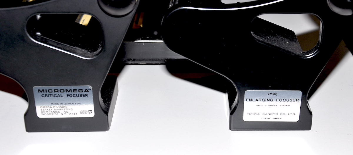

The Peak Critical Focus Magnifier with the tilting head is in a league of its own. The Micromega units are simply rebranded Peak.

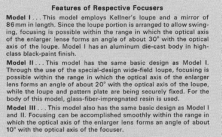

My understanding of the three historical versions of Peak focusers is that the second version permits a 10 degree deviation from centered use, and the third version permits 20 degree deviation from centered use...an important distinction to keep in mind if considering the used market to keep costs down.
According to Peak, the Model I is 30º, Model II 20º and Model III or 2030 is 10º. The 2030 is current and still in production AFIK.
The Bestwell Microsight is 25X magnification. Per the data included in the Micro Sight box, the Micro Sight is equipped with a “Large high quality triple element achromatic eyepiece.”
All thee models of Peak focusers are 10X magnification.
Here are the specifications of the three Peak models.
https://www.peakoptics.com/images/pdf/PeakFocuser.pdf
If I understand the specifications correctly, the angle specified for each model is the angle of view of the eyepiece—not the span of viewable angle as projected by the enlarger lens.
I read this differently - the loupe swings, which allows a change of angle of view.

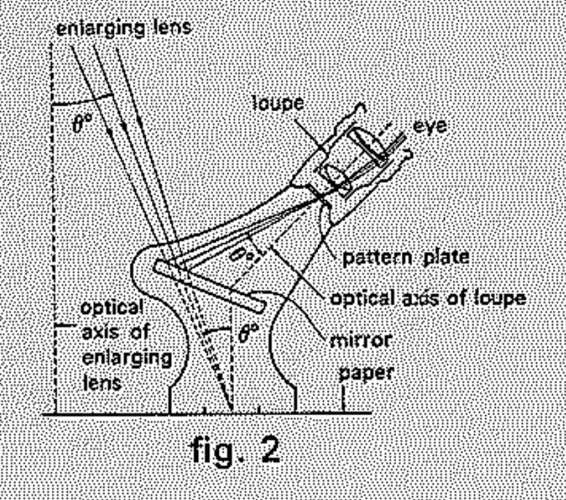

I believe the angle specified is the angle between the optical axis of the enlarging lens and the mirror of the focuser. Thus, the Model I can be used further from the center of the image than the others.
For me, I see the combination of the swiveling eyepiece and the larger mirror making the increased angle possible, so you can examine a broader area of the projected image. This comes in handy when looking at the edges and corners of large prints where your head can block the light.
Yes, Thank you. Showing the diagram enlarged makes it more easily understood.

These can be restored if in poor condition. About ten years ago I was able to totally disassemble a bargain $50 Peak 1 with foggy lenses and clean them all so that I have two of them now. That one also had a scratched mirror and I got a new mirror as B&H is selling replacement mirrors for the Peak 1(currently only $25 usd).
My enlargers are installed about 30 feet apart, so it is nice to have two of these.
