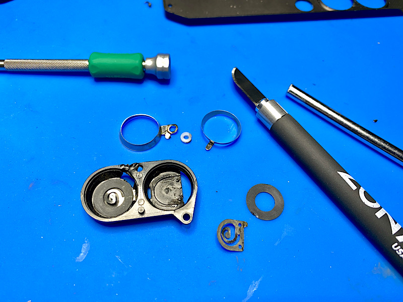

A restoration of the camera fails due to three soldering points
I'm currently concerned with this issue because I'm looking for a solution for the defective battery holder on a Canon EF.
The repair is failing because I can't solder any of the corresponding three cables onto the battery holder.
The original soldering points are destroyed by battery electrolyte and therefore had to be removed. Attaching new soldering points doesn't work.
A solution according to option three would be to completely re-equip the battery holder with contacts that are attached over the old ones. Conductive copper foil and jumper wire can be used for this. A DIY job that remains visible every time the batteries are changed.
Even if it works, is such a solution pleasing to the eye? Or is it only the restored functionality of the camera that matters?

With this view, I would totally approve your idea, provided that you don't have tolerance issues with battery length due to the possibly reduced headroom.
Just opinion, but I'd much rather see an obvious repair in a working camera than yet another good camera consigned to shelf or scrap bin because an irreplaceable part failed.
I would try "Wire Glue" first, but if that doesn't work, I'd try simply wrapping some silver or silver-plated wire onto the existing battery terminals. Why silver? Because even when oxidized, it's a good electrical conductor, unlike copper.
I have silver-plated wire, also in a thin version. I can tie it to the connections.
I have also ordered self-adhesive copper foil that conducts on both sides; I am curious to see if that will work.
Then the connection between the second and third battery has to be connected; enamelled copper wire is the thinnest conductor I have.
However, its cross-section could be too small for the load.
Definitely a DIY project.
Yes, it's tight in the battery holder, but it should be fine with the copper foil, which is thin.
I have to be careful that the minus and plus don't short-circuit, the contacts are very close together.
You mean that the remaining part of metal won't accept soldering because its surface is too heavy oxidated?
You mean clean as free of oxide?
That is not enough.
Most of these thin metal parts are chrome-plated so they accept no soldering.
You have to remove the surface down to the sheer metal.

The parts are clean, but they do not accept solder.
That may be because the part is cast zinc or zinc-aluminum alloy (Zamak, or "pot metal"). One of the classic methods of making electrical connections to die-cast zinc alloy parts is to drill a hole and thread in a small screw to hold a ring terminal. Providing there's space, of course...

Unfortunately, it is beyond my tactile resolution; the connections are very small and some of them are very close together.

Incidentally, I was able to solve the problem by replacing the battery holder.
Two Canon EFs are saved 🙃

Today I was able to exchange the defective battery holder for one from a spare part EF that is fine, see link above.

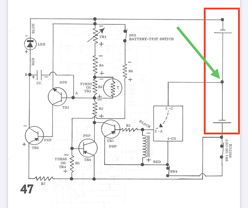

Because I believe your schematic diagram was not a correct one. I saw the diagram before (I can't find it now) but the EF powers its circuitry with 2 voltage sources. 1.35 and 2.7V for different circuitry and thus it needs 3 wires. One of my EF actually would work if I install only 1 battery. I need to get that diagram again and study it more. I believe the 2 batteries in series provides 2.7V to the long shutter control circuit. One of the battery alone would power the metering circuit and aperture control in auto mode. I believe the one EF that only works with 1 battery has a bad circuit in the electronic shutter. When 2 batteries are installed it would draw too much current and basically kill the power from both batteries. With only 1 battery the metering circuit and aperture control works but I don't have shutter speed of 1 to 8 seconds. Only from 1/2 to 1/1000 which isn't bad.
Because I believe your schematic diagram was not a correct one. I saw the diagram before (I can't find it now) but the EF power its circuitry with 2 voltage sources. 1.35 and 2.7V for different circuitry and thus it needs 3 wires. One of my EF actually would work if I install only 1 battery.
According to the Nat Cam Service Manual, there were several versions of the circuit.
This section of a circuit diagram matches the connections on the battery holders (2 x 1.35 volts) of my three EFs.
1.35 volts come directly from one battery.
