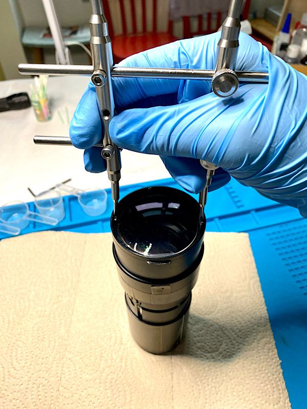

I used this spanner wrench from Neewer just yesterday.
Its solidly made, has withstood all the stresses so far, can be secured with hexagon screws or rotary screws, and its tips/blades can be set up inwards or outwards.
You have to be careful with all models. Not only because of the possibility of slipping and scratching, but also so that the tool doesn't hit your face. High torques are used and if you slip, the tool can get out of control.
