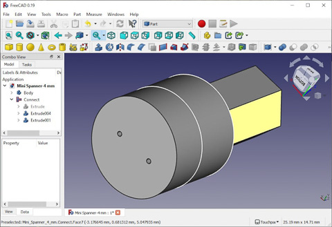

I design and 3D-print my own miniature spanners, using ordinary PLA plastic for the body, and steel wire for the pins. I designed mine to fit into a standard ratcheting screwdriver.

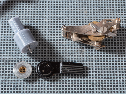

Here's mine, but so far I've had to create new tools for each make and model of camera that I've worked on, because there seem to be no standard sizes. Rather, I think specialized tools were provided by the camera manufacturers.
