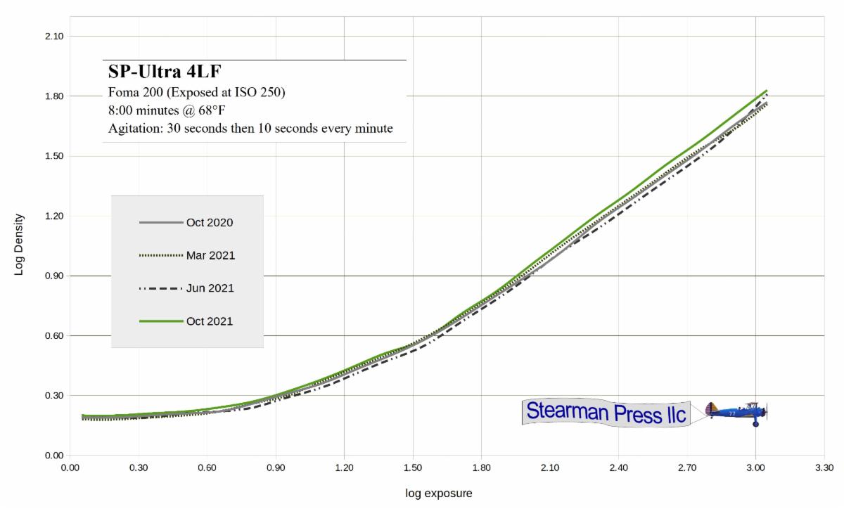

Can't believe it's been over a year since we introduced our SP-Ultra 4LF! One of the only developers optimized for large format film in the last decades.
As promised, we ran another Density vs Exposure test on the pouch that's been sitting on the shelf since last October:
Boring. Boring is good. Indeed, the results are well within the expected limits of our test equipment, shutter accuracy, and everything else that affects the analog world.
We've got just enough of this batch to run one (maybe two) more tests and will update you again in a few months.
