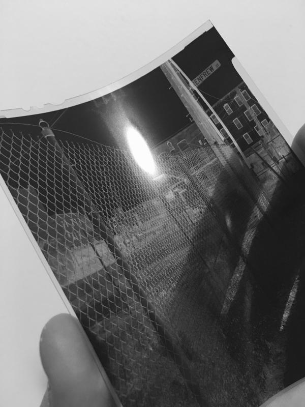

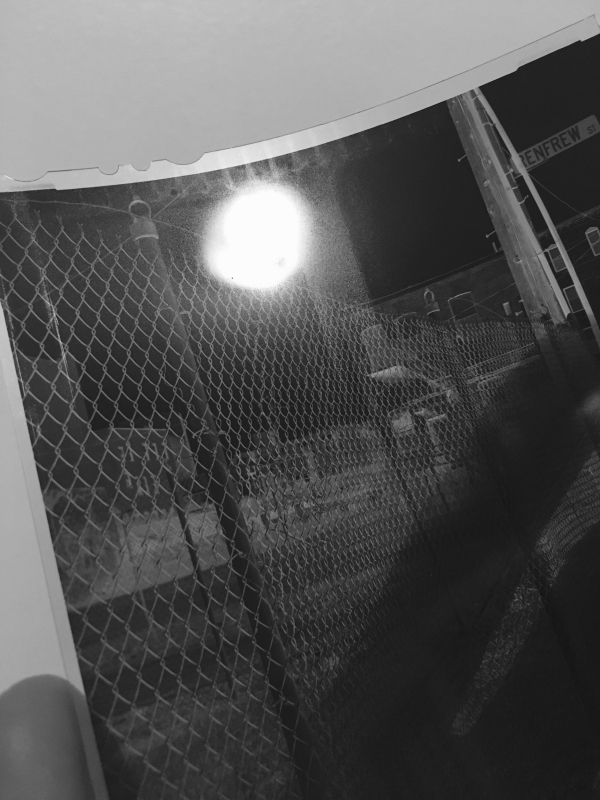

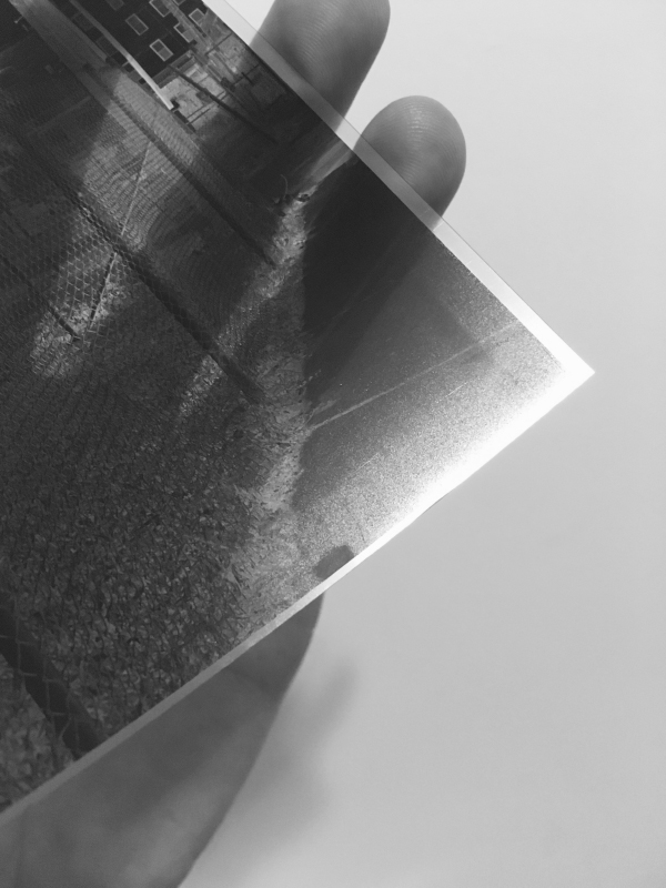

Would like to reopen this thread up with a question—
Has anyone had an experience where the polyester base of the film (non-emulsion side) shows a ghosting of the shape of the holder? I have the second iteration of the film holders which are essentially one giant, open rectangle with a single bar down the middle. I've attached pictures for reference. Obviously this is really irritating and I'm hoping it doesn't show up during digitization.
Is there any way for me to clean this off? It seems to have a bit of dimensionality, so I am mostly curious if a simple Edwal film cleaner would do the trick or not. Hopefully I don't have to rewash it. Any thoughts?
Thanks a million!

Yes, I do see these "ghosts" too, on a regular basis. They do however not show using traditional dark room printing, that is neither in contact printing nor in enlarged silver gelatins prints. I have never scanned them, so I can't really say what happens there.

@Fraunhofer here's a theory...do you do a pre-wet on your film? I wonder if this is causing too much swelling prior to development which therefore causes the film to make more contact with the holder during development.
I sometimes do a pre soak and sometimes not. I have not noticed a correlation.

Are you doing a sufficient enough pre-wash? I've never had these show up, but I wash until the water runs clear. Perhaps this is just some of the backing that was not washed off thoroughly?

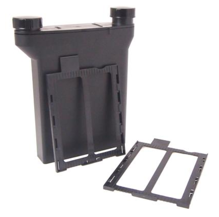

Purchased this developing tank, and it just arrived yesterday, excited in using it, and searching the web noticed today that there is a new film holder design.
With the older type, second type, not solid plastic, but with the single center support as in post #34, has anyone had any trouble with these, or have notice any warping of their film holders?
Or had one break?
It looks like the newer ones with three center supports would be less fragile and stronger,.
It seems that this is a relatively new addition to the SP-445, as the one we received as the single center support, so would like some feedback before we use it.
