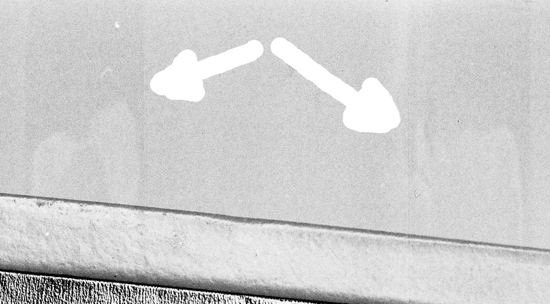

I have run 12 sheets of film through this tank system and have had problems with streaking on the back side of the film where it touches the holder's ridges. My first few sheets had almost every ridge visible. At the suggestion received on another forum, I increased my agitation and included a full aggressive 60 second wash cycle with photo flo as the last step. This did result in a few sheets without the streaks. However, my last batch has had the problem reoccur, the streaks are from the wide ridges near the center of the holder. At a 50% success rate, I am not sure if this is going to work out for me. Is anyone else having this problem?
I am using Bergger Pancro 400 film, that is currently the only 4x5 film stock I have. The arrows are pointing to the marks left by the two ridges, image is a small section of the negative.

Make sure your film holders are "flat", we've heard of one other user that had a slightly curved film holder that could cause the film to be pressed against the holder. If so, it's pretty easy to just warm up the film holder in hot water (not boiling!) and straighten it with your fingers.
BTW, we've processed other films with a coating on the back with no problem.

I don't develop sheet film and I'm not familiar with the process you are using but I'm wondering if my experience in doing RA4 color prints in a drum could be relevant here. I got streaks on the prints if, when I emptied the developer, I drained the drum to allow nearly every last drop of developer out. If I go more quickly to adding the bleach/fix (stop in your film case), I get no streaks. I assume that extra few seconds of a thin layer of developer moving across the sheet is what's causing the streaks.

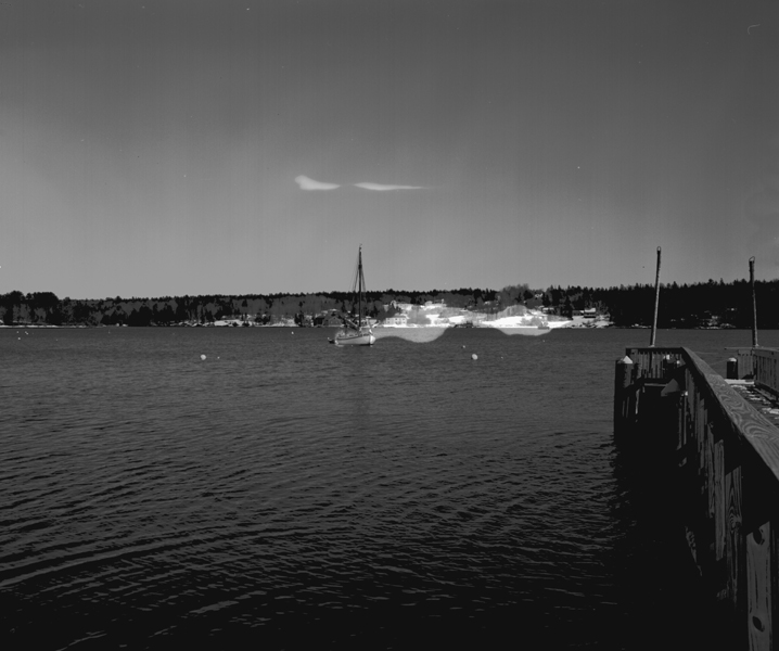

I have run 60+ sheets through the SP-445 tank - my first try at home development. I have been very pleased with the results, but started having problems when I switched to Ilford FP4+ from the Fomapan 100 and 400 I had used previously. I started getting blotchy areas of over-development, and have determined that the problem spots always line up with the film holders' crossbars, specifically the ones with the small circles left from the molding process. One of the circles on each of the two holders has a slightly raised area (not trimmed properly in production?) and this seems to be the area where the blotching is the worst. Always on only two of the four negatives, and always in the same place. This occurred on the last two development runs. The molding circles are only on two of the four sides of the film holders. Perhaps developer is getting trapped around the raised part of the film holder's crossbar and not getting washed off? Does the developer soak through from the back of the film into the emulsion? I have used both the SP-76 developer from Stearman Press, and Diafine, with similar results. Anybody have a similar experience? Suggestions? The film holders are NOT curved, and the film was definitely loaded with the emulsion side out. I have uploaded an image showing the blotches.

Doug,
Can you email a higher resolution scan? I can't really see what you describing on the file you uploaded.
Frankly, I don't think the film holders can affect the emulsion. Could it be anti-halation coating not getting washed off?
You could try a some fine sandpaper and smooth them up.
Tim

Tim, Thanks for responding. I will email you two images, high-res, showing the flaws. I processed 4 sheets of Arista 400 2 days ago and had no problems, but I agitated much more vigorously and washed longer and with more agitation, but then the problem never occurred with the Foma or Arista films, only the Ilford FP4+. I'm new to this forum and nor sure how to send you the files - do I upload them here or send to your email address at your website?

Thanks for your help. Yes, it was the anti-halation coating that had not been washed off, because the film was being held against the crossbar of the film holder, both by the curvature of the film and a VERY slight curve in the holder, preventing the wash water from reaching the film at the point of contact. At your suggestion, I soaked the developed negatives in plain water for 5 minutes and the blotches dissolved, leaving a perfect image (well, at least an image with no technical flaws). Being a newcomer to home processing, I am grateful for the advice and support offered by you and others on this forum. As we discussed via email, I am going to try loading the film in the holders in a different way, or possibly modifying the holders in some way, but I have straightened the holders in warm water and scuffed up the crossbars with 400 wet/dry sandpaper to help prevent adhesion of the film, so I don't anticipate any further problems.
