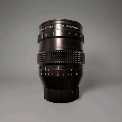

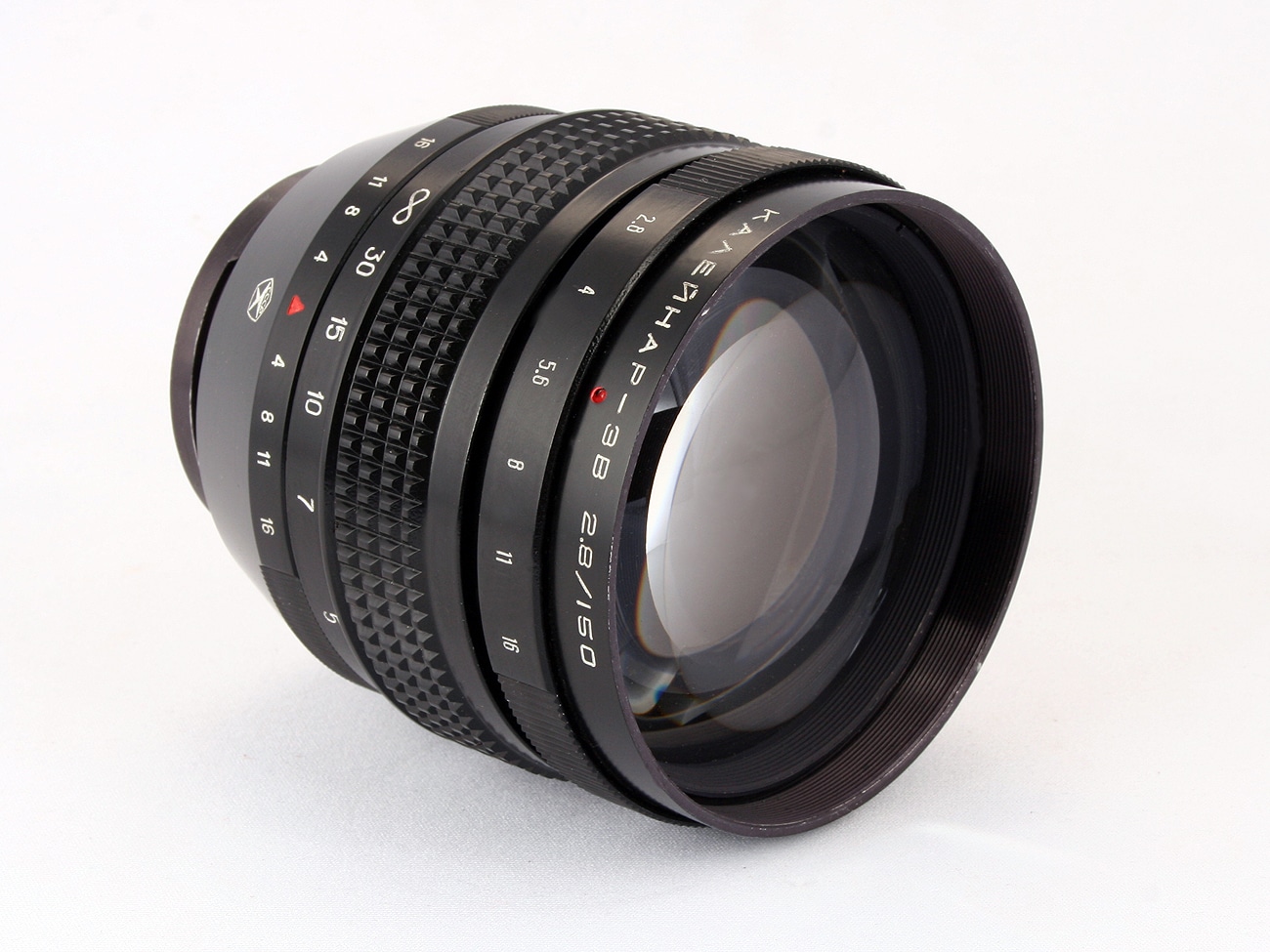

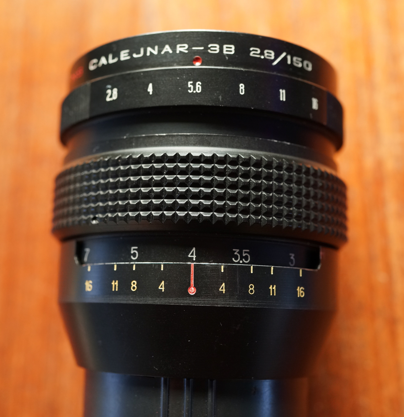

I've seen ik numerous posts something about the Calejnar. I just can't seem to find those lenses online. Can you share a link?
Calejnar-3 was an official latin transcription of Калейнар-3 150/2.8 lens.
You can find it as Kaleinar, Arsat or Hartblei 150.
Grab this one and use it with the P6-K88 adapter ring. You will never regret it.
