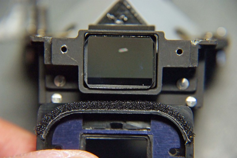

This was the trapped shutter curtain causing the shutter problem...

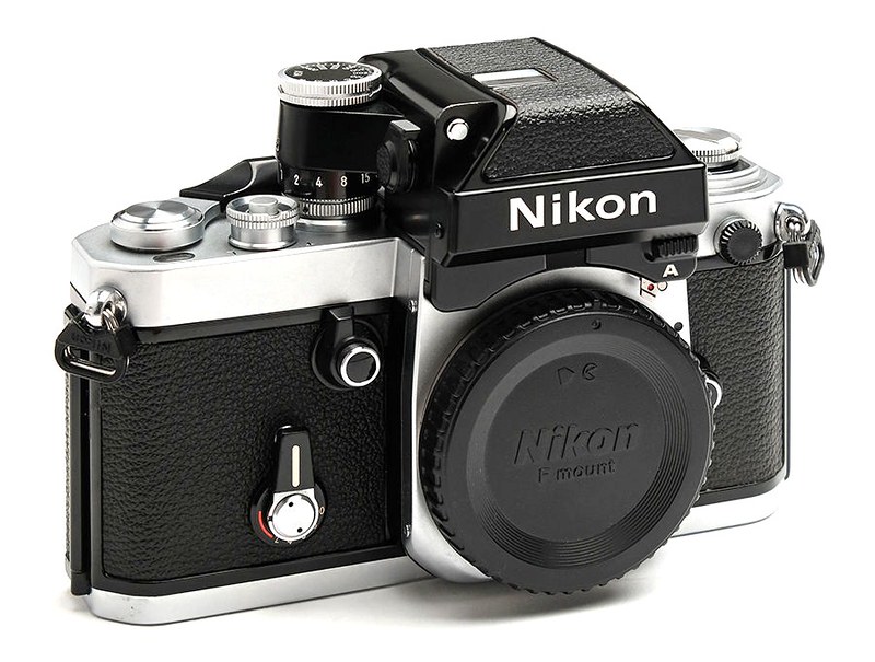

By the way, this is what the camera looked like when I received it. Would you have thought anything could possibly be wrong with such a camera? I didn't. Beautiful on the outside but rotten therein.

Nikon F2 by Narsuitus, on Flickr
