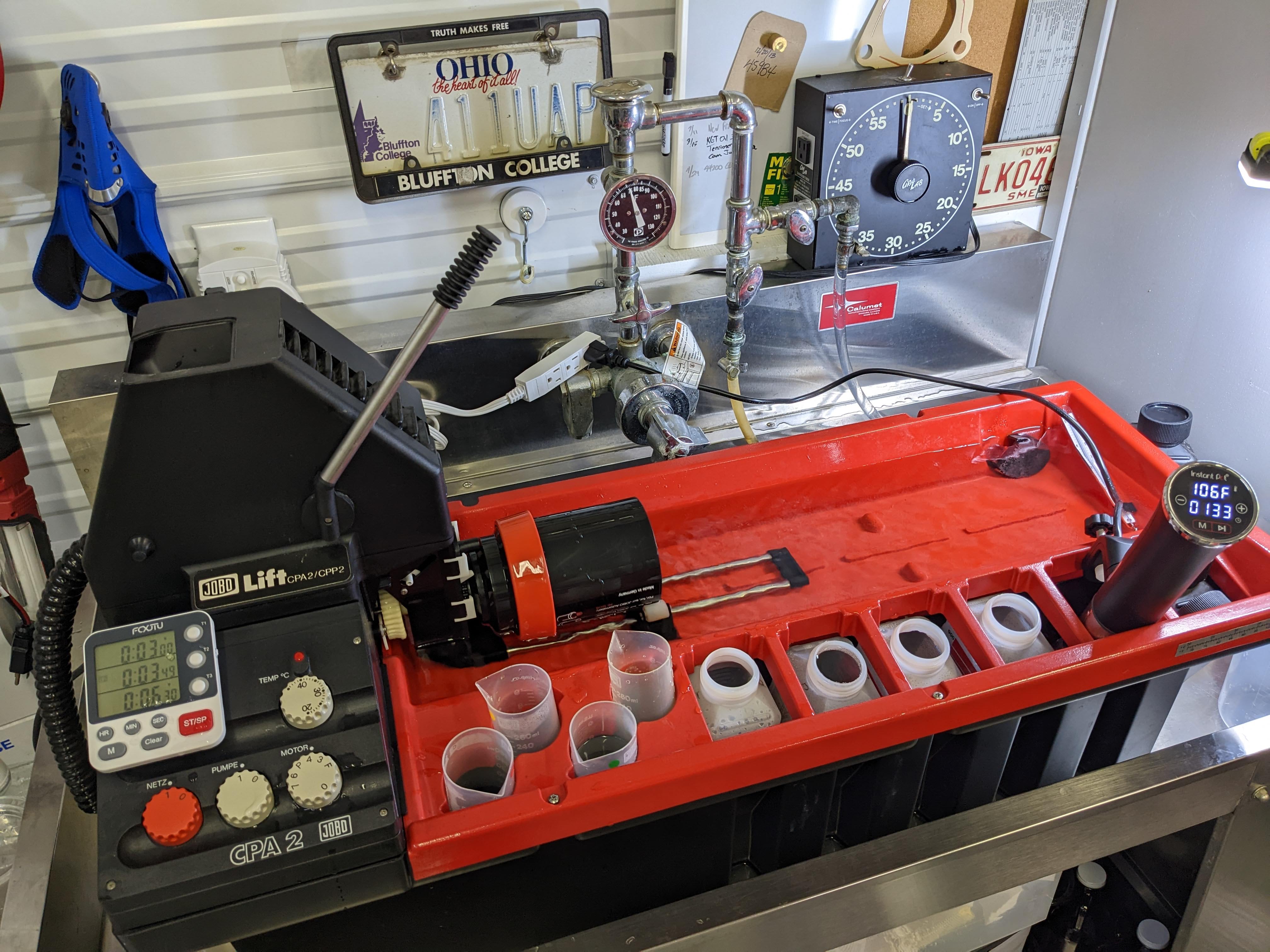

I enhanced my Jobo CPE-2 with a sous vide because it is far more accurate and precise than the built in thermostat. It also provides a temperature homogenity that is far superior to the convection style heater.
Being a precision fanatic myself, i did extensive testing with an reference thermometer and found a temperature homogenity and stability error of <0.1K, which is pro-lab-grade to me and it can be set by numbers, not by
a coarse knob with pracically no scale.
So, this was a very cheap add-on for me, but one of the most useful. It frees my mind from worrying about the temperature stuff, provided that careful initial tuning is done. Bottles create some temperature drop
by conducting heat away via their tops that are in contact with air, same goes for the development tank itself. Everything is in the sub 1K range, but for color, we want to be more accurate.
One just has to measure the temperature over time in the tank in appropriate intervals over about 8min to get an idea if the effective processing temperature is within spec. At the end of the day, the temperature of the
developer in the thank is what matters and not the water jacket nor the temperature in the bottles.
Before the Jobo, i used the sous vide in an bucket, also worked great. Homogenisation and stability is the key.
Fyi i mostly do E6 and the sous vide is the one from Cinestill.
I can highly recommend such a device and a process thermometer. It enables very good and tight temperature control with low cost.
So I guess I didn't invent anything revoulutionary then. Darn. But I do think this is much more precise than the guess-o-matic dial. I have mine set to 106* (41ish?) as I was running an experimental ECN2-ish run of film.
