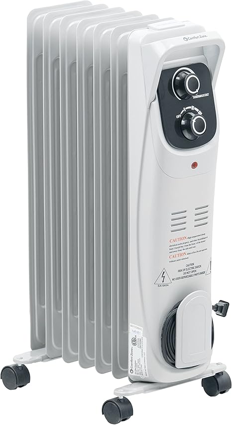

JVO made a good point, what the temp of your basement? If close to 68 then maybe a electric radiator with baby oil would keep your space at 68 without any fuss. Here is the desert my problem is cooling, in the summer I crank the AC down to 70 while in the darkroom.
What is a "electric radiator with baby oil"?
I know electric heaters, shaped like a classic radiator from a central water-heating, but filled with oil. Got such myself, but your wording puzzles me.

I think that "baby oil" may be more commonly referred to as "mineral oil" in the heater world.
