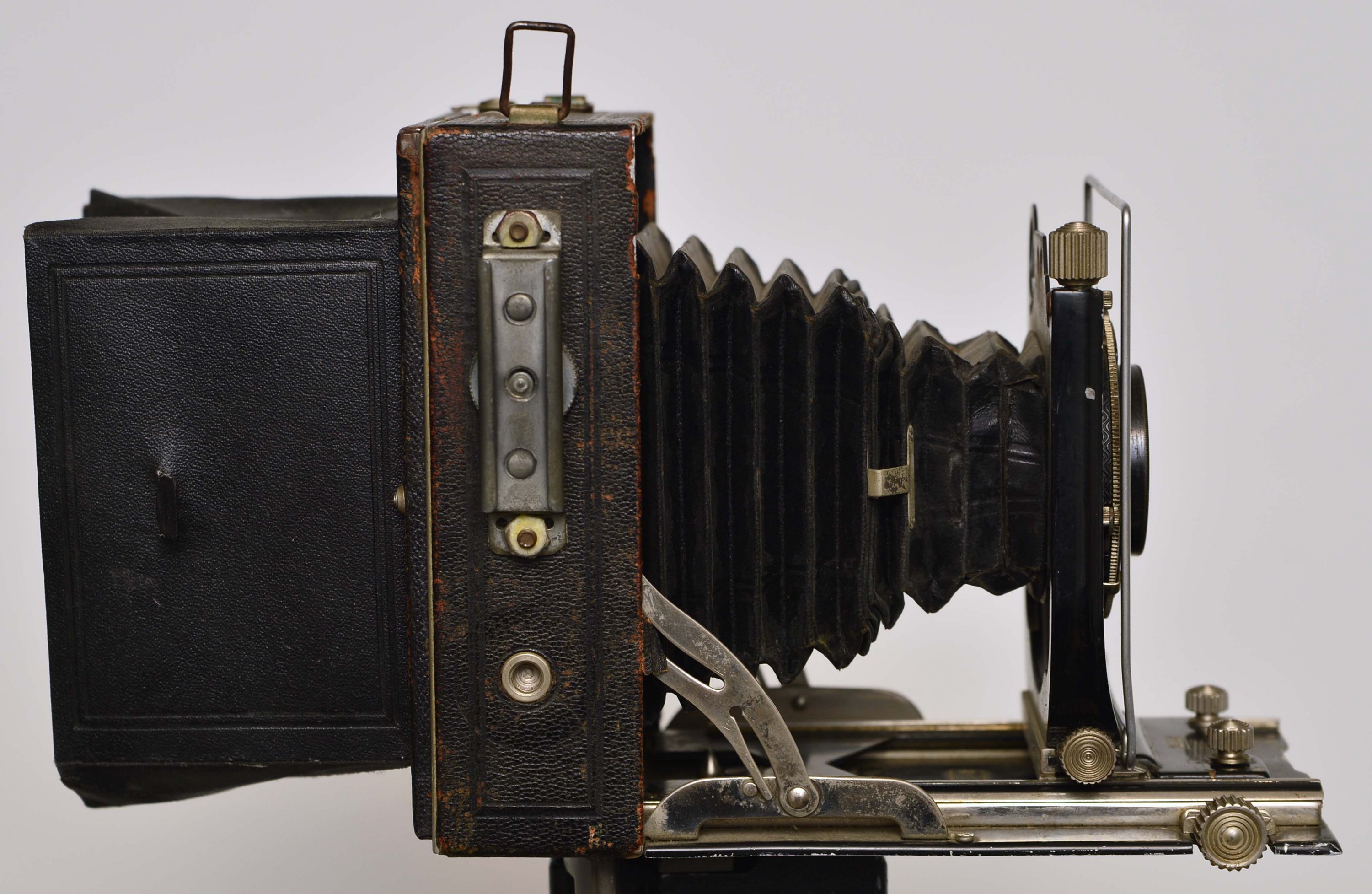

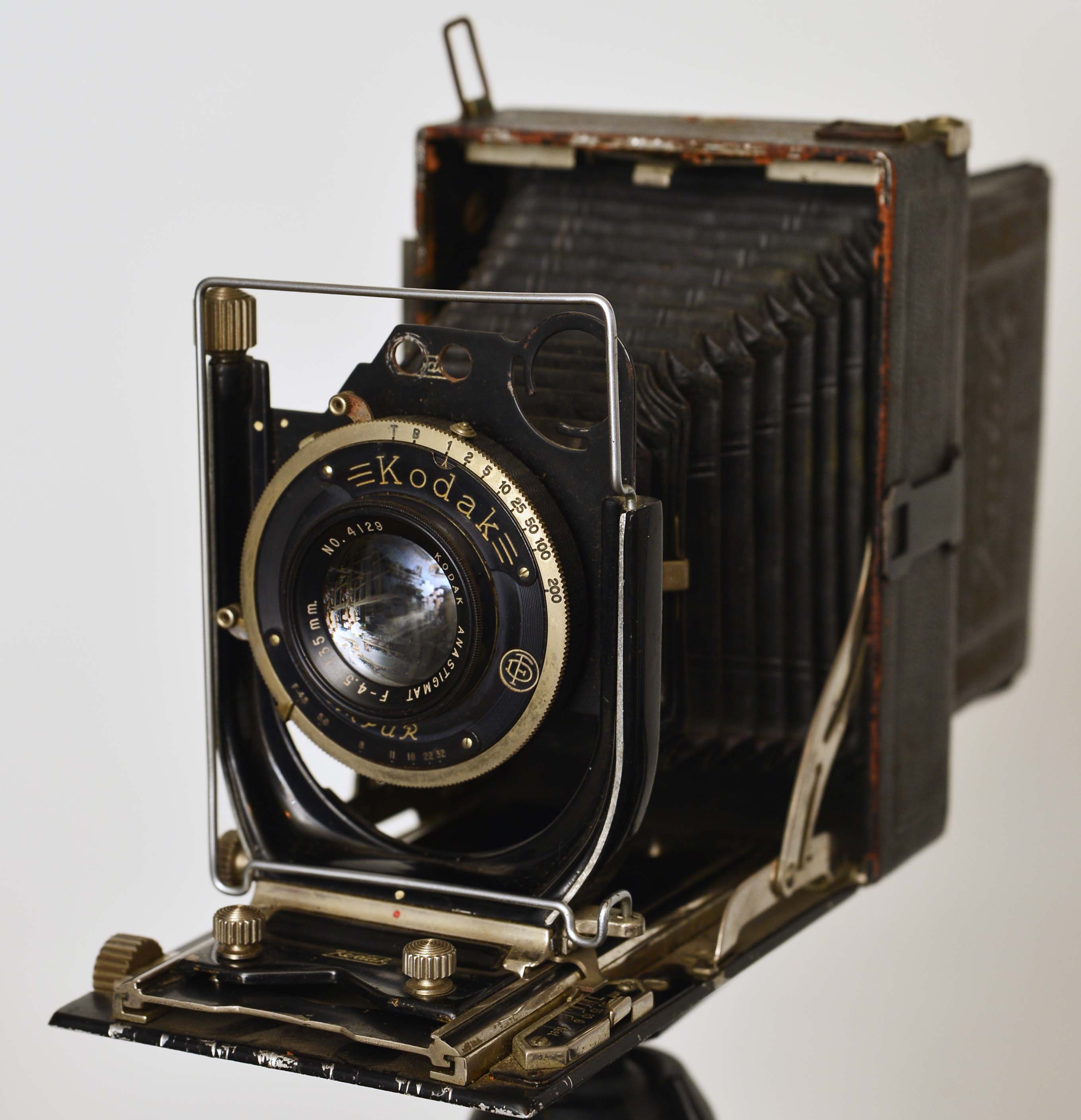

Hi Ken, I was just getting ready to ask a question about replacement glass for an old Kodak Recomar folding camera. The ground glass in it was broken and the previous owner used masking tape to hold it together. The ground glass is 3-1/2 x 4-3/4 inches. It uses 3-1/4x 4-1/4 film. The lens seems to be in good condition for such an old camera. I don't know if I can buy the correct size or cut down 4x5 film for it, but it would be fun to try to use it. I don't know how much it would cost to ship from Canada, but I may be interested. Thanks
