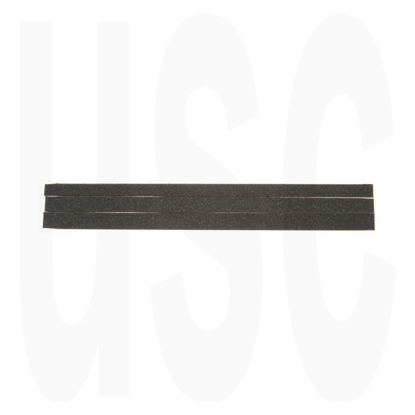

I think it's time for me to replace the light seals on my Minolta X-570. Does anyone know of a reputable seller for light seal material or light seal kits?

If you want to cut your own, US Camera sells offcuts of the right foam very inexpensively:
