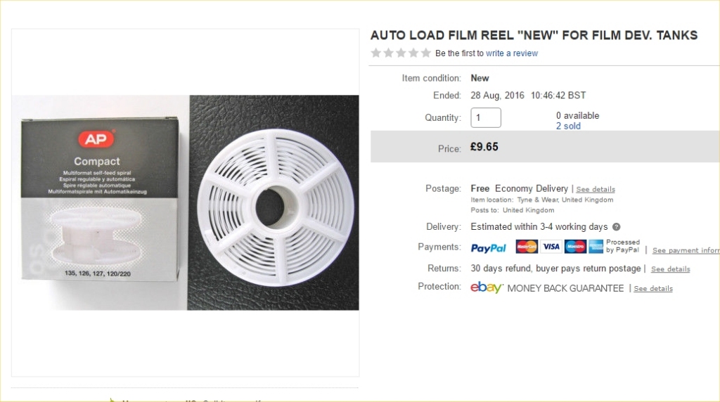

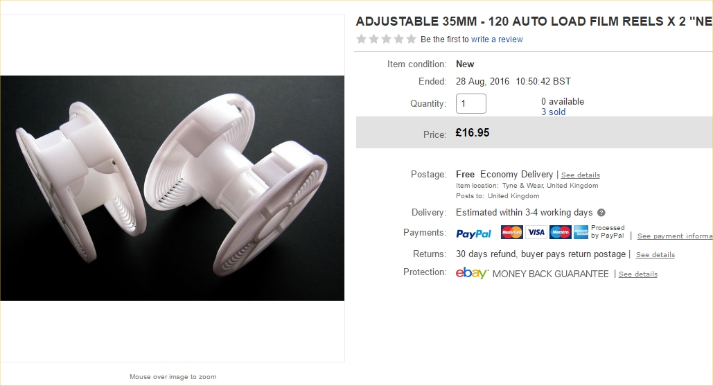

The cost is too high, BHP have a reputation over here as being the one shop WE WISH WE had, the videos and expertise is great but they are in the USA........................... bummer
CMoore
Aug 23, 2015
6,289
USA CA
THIS is why
Subtotal:$21.98
Shipping starting from$13.51
Duties & Tax $31.01
You Pay$66.50
I have no idea what shipping would be.
Do the tax and duties apply if somebody from the usa ships it to you.?
Shipping (in the usa) is free, on 50 dollar orders.

The excessively large tabs on those reels kind of worry me. I've come across multiple people online who ended up with excessive scratching on their negatives from reels with similarly large feed tabs.
