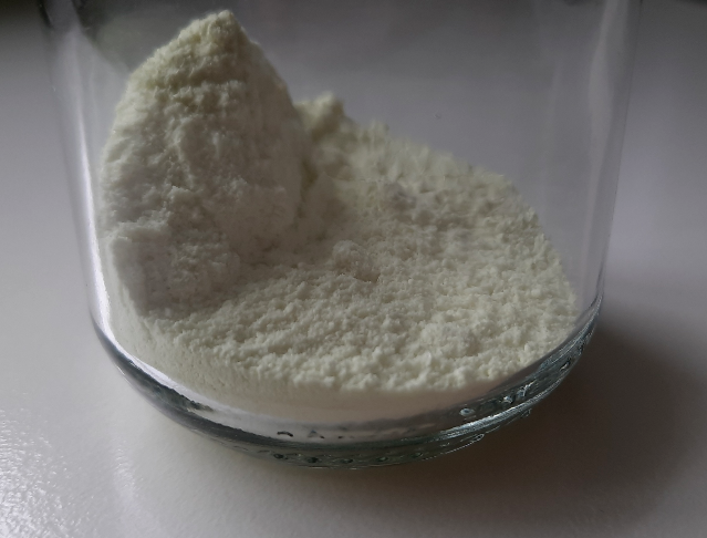

Presumably it's ammonium thiosulfate separating, as it now has a pretty strong sulfur smell.
As @mshchem explains above, it's not thiosulfate, it's actually sulfur. Especially in acid fixers, self-decomposition is a problem and it tends to accelerate. Your fixer is basically toast at this point. You could filter out the sulfur, do a strip test with the fixer and then continue to use it, and it'll likely work. But evidently it's recommended to just purchase some fresh fixer instead.
Here's some elemental sulfur I 'harvested' from a bottle of decomposing fixer part from a Fuji RA4 blix (for all color printers out there: do NOT buy CPRA blix; instead, stick with the monopart stuff!)

It is elemental sulfur. If the fixer is unused, or used only for some times, sulfurization of fixer will lead to precipitation of elemental sulfur. But if this reaction happens in used fixer (or in blix in color paper process RA-4)., the product will be a black salt. silver sulfide (Ag2S), which will stain all the vessels and equipment. It is very ductile. almost like a metal, and is not soluble in water. It is actually the same compound that tarnishes silverware and jewelry. Kodak recommends using a household bleach (sodium hypochlorite solution), followed by standard photographic fixer for removing these stains,
