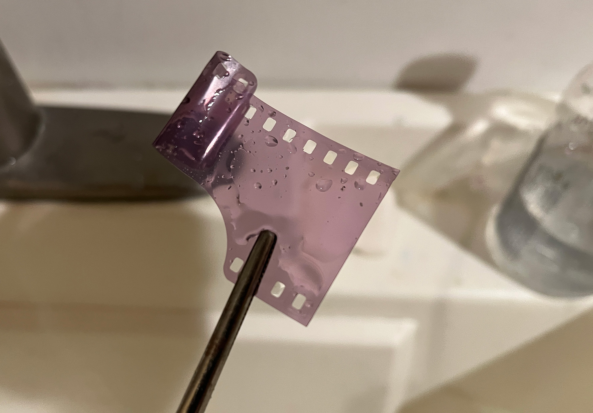

My Rapid Fixer also has that sulfur crust at the bottom. I think it's now 10 years old.
I did a small test, and it cleared a Tri-X 400 after about 30-40s. I left it in there for a total of about 3 1/2 minutes and this is what the film looked like
I couldn't really see a change between the initial clearing and the following 3 minutes. It looks good to me, although still quite purple.
Does it seem usable?
I'd much rather use up the old stuff instead of buying the fixer-hardener combo or the 1 gallon "part A" bottle. And I don't know which other fixer to use for all my expired films.
koraks
Nov 29, 2018
26,158
Europe
Yup. Filter that fixer before using it; the fine sulfur particles can find their way onto the emulsion where they will be difficult or even impossible to remove. It'd be a shame to have each frame appear as if it's photographed through a drizzle.
Welcome to Photrio!
I'm not sure whether @koraks meant to say "Yup" :smile:
Personally, I'm reluctant to trust the efficacy of filtering in this situation.
Even expired film is much more expensive than the cost of fixer.
And the cost of a lost opportunity due to quickly degrading negatives seems important as well.
Of course it would be okay if you segregated its use to things like test rolls used to see if the film is functional, or that a camera was working properly, but I would want to use fresher stuff for negatives and prints I hoped to keep for a while.
Yeah, I did alright, although I understand that some may disagree. However, given my own experience with fixers that have started to sulfur out combined withe successful clearing test, I would personally feel OK using that fixer after having filtered it. However, I would not rely on the officially stated capacity of the fixer (just use it one shot) and I would also recommend to perform a similar clip test before committing any important roll of film to it.
Keep in mind that film can be refixed even if it didn't go to completion first time round.
