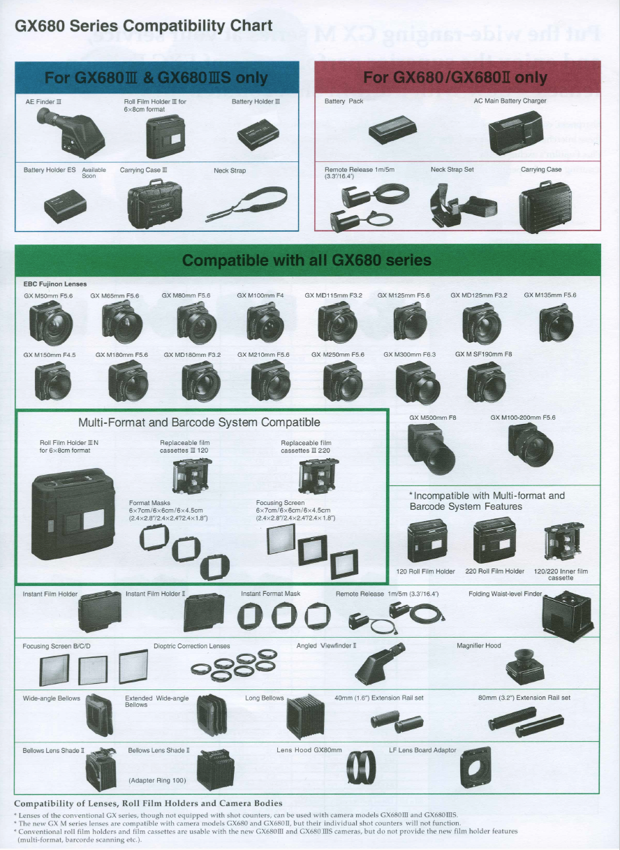

I'm curious about the backs. Is the III and IIIn the same back? They have their own 120/220 inserts? And finally, can earlier generation backs be used on the IIIs camera?
I'm using the IIIs again but thinking about getting another back.
Hi there - yes indeed all backs work across models, or at least the type before IIIN work fine, though the IIIN will likely lose the multi format mask functionality for non type III camera bodies. Good 120 film backs can be found from 50-80 dollars used and work quite well.
All the information the OP asked for is on the sheet from the brochure I posted. Most relevant is the not at the bottom of the page.
Thank you for the brochure. There are two III film backs it looks like. III and IIIN. Are they the same?
It looks like if I want to use version I and II backs I need to make sure the battery is good or don't remove the back until the film roll is used up. Correct? I'm not looking to have many backs, just maybe one backup and a 220 insert to finish off my remaining 220 film ( and any more I might pick up ).
Thanks again.
The IIIN is the most recent type, which takes either 120 or 220 inserts to determine film types. The older cheaper non-N backs have either 120, or 220 marked on the back itself, and a single insert, that is not interchangeable. You don't HAVE to replace the battery in the older backs, doing so requires cutting and re-soldering a new battery with leads into the back - but without the battery you will lose the number of shots taken when the power is switched off on the camera itself, or the back is removed. Also not sure if this is normal, but before I changed the batteries in the older backs, the connection must not have been great, as the circuits died, the back gave errors and upon rotation, it would lose power and freak out. Since I've replaced all my batteries no more issues and the backs work as normal. Since this was the case with 4 separate older 120 backs, I can only say it looks like when the battery dies sometimes it doesnt die gracefully and causes circuit issues inside. :smile:
The IIIN backs I should point out, are pretty nice with their removable battery and multi format capability, however I find the older ones fine for my work - your preference will come down to cost.
As a final note - I actually have an old 220 back if you wanted to pick one up cheap though I am out of batteries to replace that particular older one since redoing all my 120 backs.
