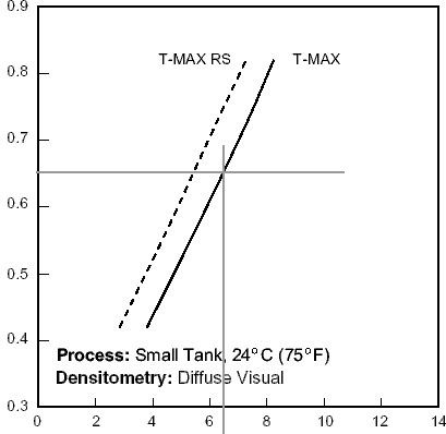

Don, I am trying the TMY-II as we speak. After looking at the times for TMAX developer, they quote iso 400/800 at the same time for 7 minutes @1:4 dilution. TXP was 7 1/4 @ box speed. So not much in it really.
I went out into the back yard and ran some tests @ 400 and
800 and will use the standard dev time in TMAX developer to see how it looks.
A.
Andrew,
The reason I spec'd the CI time instead of the 'push' time was to get you to a real time ! Check the CI tables at the end of the Kodak document , and you'll see this the .gif below. 6.5 minutes, with agitation every 30 seconds should make that one stop bump. 7 1/2 ' at 68˚ would be a good idea. I'd extrapolate further and divine a time based on 1 minute agitation: look at the 'large tank' times.
I suggested D-76 because there is more of a curve through the shadows than T-Max developer has. I think HC-110 would also be a better choice the T-Max, if we want to mimic TXP.
d
