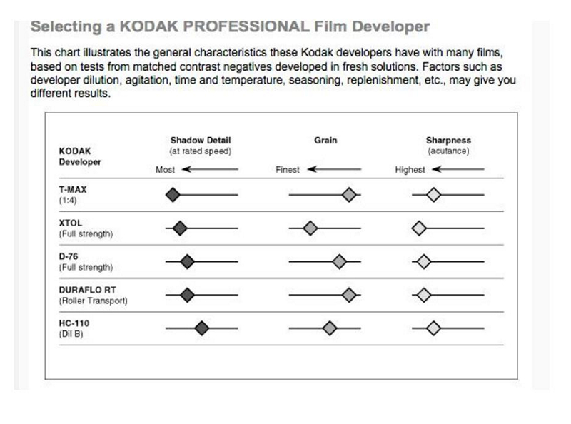

There is this Kodak chart:

Well, the problem with that dumbed-down Kodak chart which has been reproduced innumerable times is that the characteristics of some of those developers dramatically change with different dilutions or degrees of development.
But I haven't used any packaged Kodak developers in the last 30 years except for HC-110, which I tinker with using added ingredients anyway. And I'm still using bottles of the old stuff; haven't even tried the last two renditions of HC110 yet ... maybe never.
