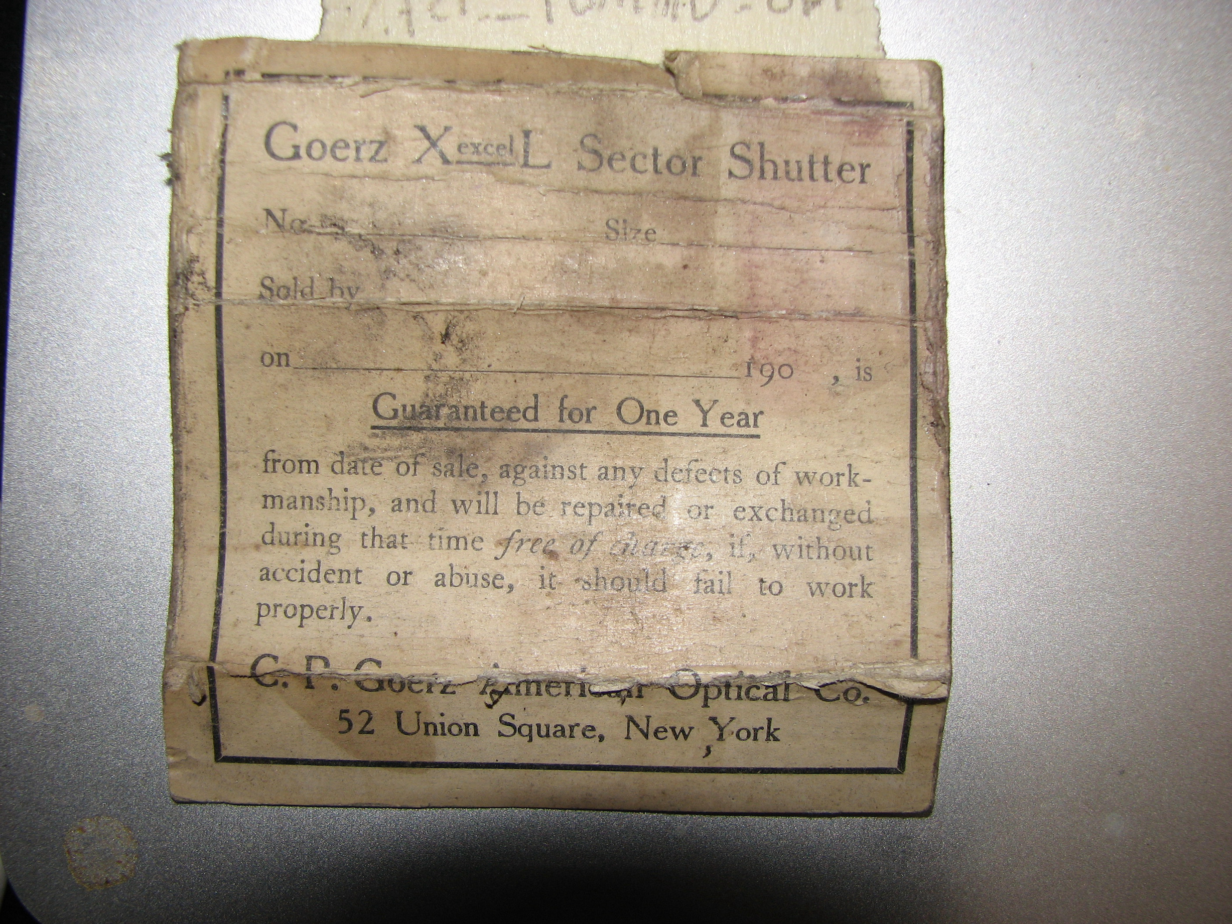

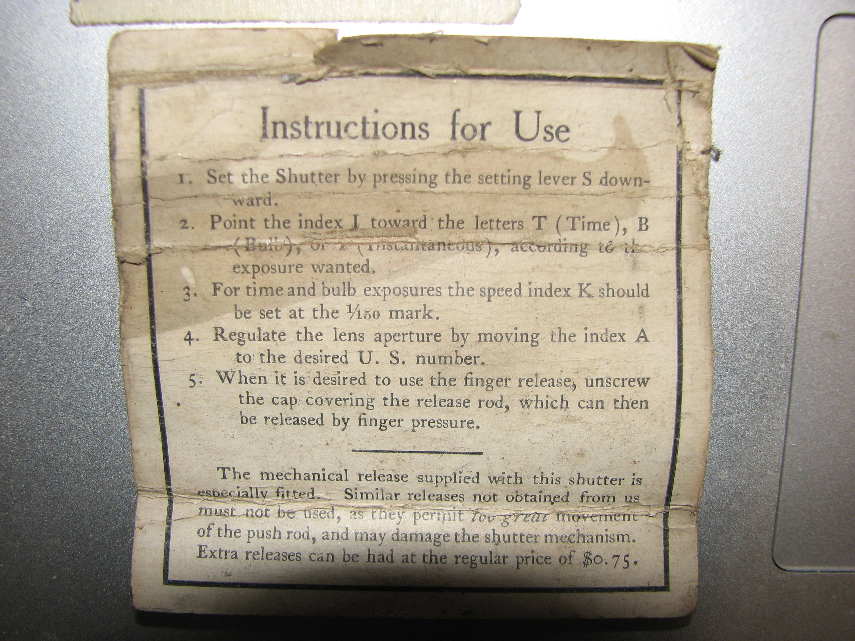

In the box of stuff that came with the camera I found the original guarantee / instruction card for the shutter. The instructions are the usual for this type of shutter, but below that there is an interesting paragraph regarding the release cable.
"The mechanical release supplied with this shutter is especially fitted. Similar releases not obtained from us must not be used, as they permit too great movement of the push rod, and may damage the shutter mechanism. Extra releases can be had at the regular price of $0.75."
Do we think there is any truth to this, or they just wanted their $0.75?
Unfortunately, I dont think I am going to receive a release if I mail 3 quarters to Union Square, NY.

vjuliano
Feb 6, 2021
65
Seattle, WA
yeah and the first 2 digits being '19' meant I couldn't forge it to try and get a warranty repair. :smile:
